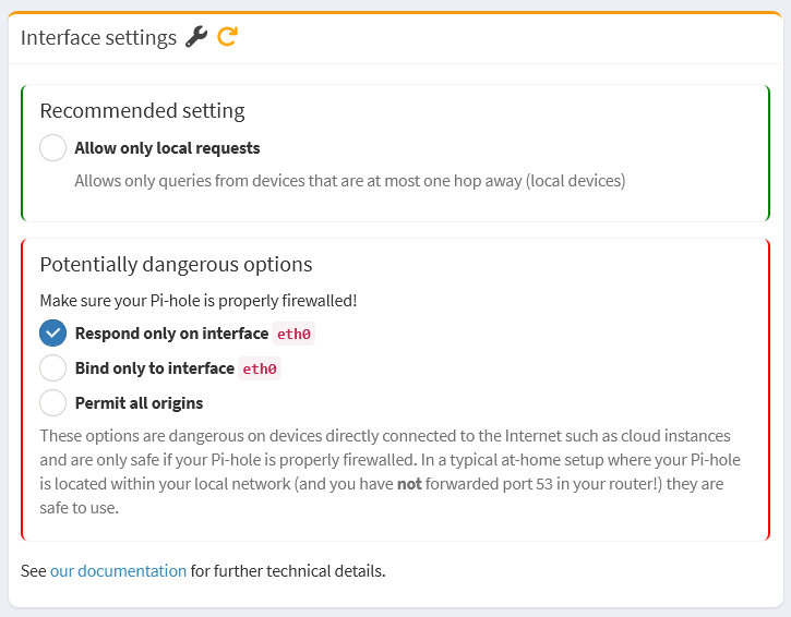

The warning is expected, since Pi-hole is configured to listen only Local queries (from the same network):
listeningMode = "LOCAL"
Change the interface settings on the Settings > DNS page.
(If you can see the Interface settings box, switch from Basic to Expert mode, using the button on the top of the page)
