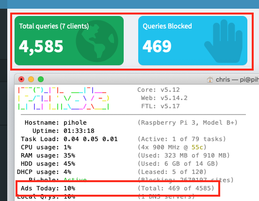

On a related note, while the Dashboard refers to them as Queries, the Chronometer does in fact refer to them as Ads. The Chronometer wording may need tweaking.
Agreed.
https://github.com/pi-hole/pi-hole/pull/4910
