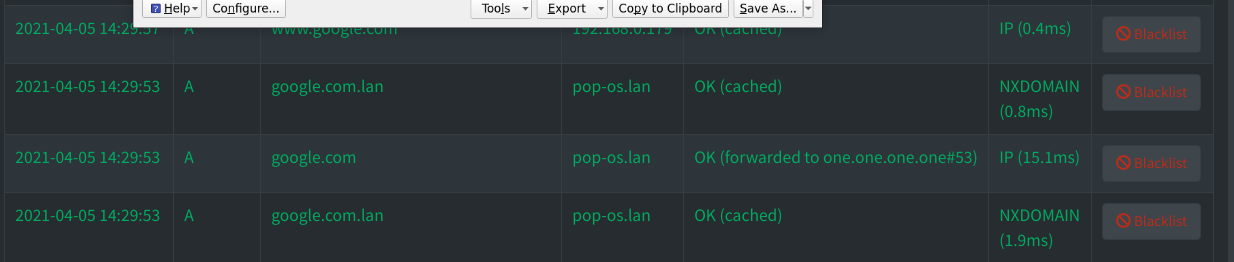

What evidence do you have that this is the case? Some output from your logs would be helpful - in particular from /var/log/pihole.log

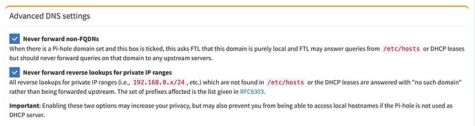

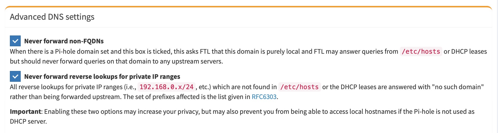

Pi-hole will route any traffic that it receives per your settings. Is google.com.lan resolvable on your network? You have selected the following two options (shown in your debug log as follows) and this tells Pi-hole not to forward those queries to the internet for resolution. The domains don't exist on your LAN either, thus the NXDOMAIN reply.
    PIHOLE_DOMAIN=lan
    DNS_FQDN_REQUIRED=true
    DNS_BOGUS_PRIV=true
What client is making the request for the domain google.com.lan? That's where the problem lies.
Maybe it is Windows. When the upstream is slow, it will try again the same domain with the network TLD attached.
