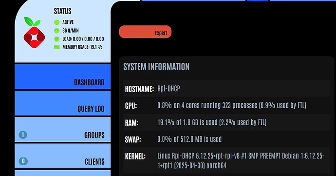

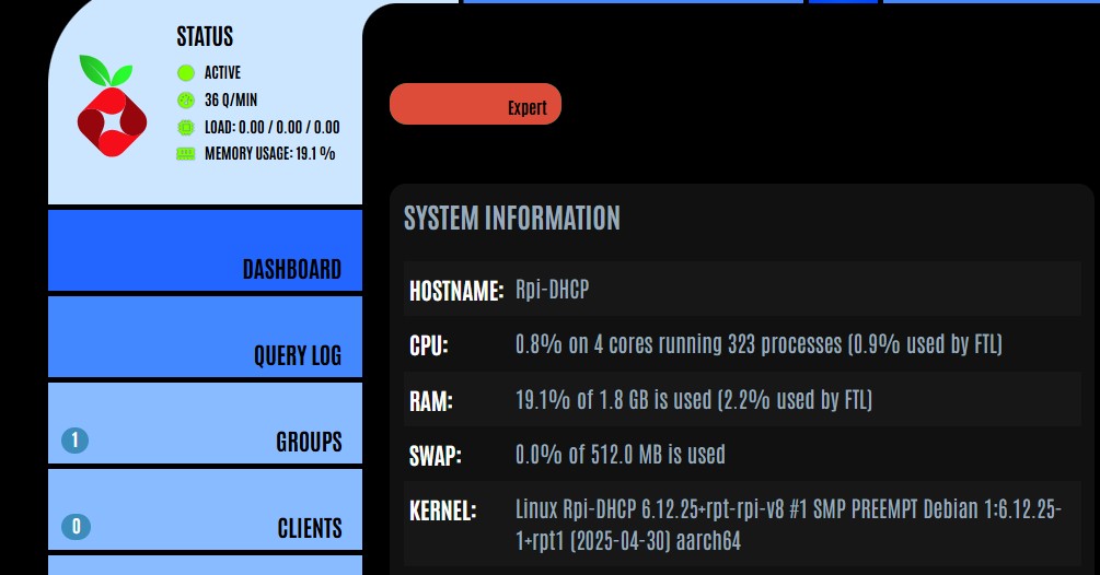

How does your swap file usage look. I've seen similar with underpowered and overloaded RPi where swap file was constantly at 100%. The overloading was caused by me having too much stuff running on the Rpi.
