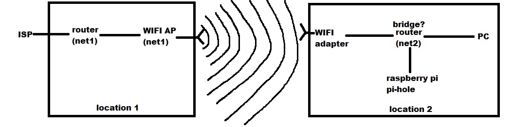

Okay i am aware that i cannot just plug the wifi adapter into raspberry pi and then to the PC. I need a router too. Check the uploaded illustration for explanation. something like this i would like to achieve. I need the alfa WIFI adapter because its long range adapter and has a lot of useful features. the WIFI of raspberry is not good choice for my setup i think. and the problem is that the ISP has locked the router so i cannot login without username/password. and the router from ISP is a combined router/WIFI AP so its alredy broadcasting WIFI. so my choice is to receive this WIFI signal somewhere on a different location and manage the DNS stuff somehow. Is it possible? I have read that such routers are rare if exist at all - which have USB port to connect a WIFI dongle. most routers with USB port are for uploading files, connecting printer, connecting network HDD, etc. but not for connecting WIFI adapter. So i might have drawn nonsense. But maybe a bridge would be good? or use as range extender? (i mean bridge or range extender where i have drawn the router)
Thing is i dont know anything about network implementation, infrastructure so it may be not possible what is on the illustration. How could i solve the DNS redirection on the location 2 side?

To answer the missing data: i have a backyard, a family house (location 1) and a "research/experiment room" (location 2) at the end of backyard approx. 20-30 meters away from house. My ISP has blocked access to router/AP in my house so i cannot modify settings. and i would need to setup pi hole mainly in the backyard room because thats where i use the net mostly. And i would like to have full control over my devices if i want to change something- so leave the ISPs router alone and create at location 2 my own network with pi hole enabled.
and since i cannot modify router settings in my house i thought maybe i could create a different network segment in the backyard room with its own router- or somehow configure the RP so it would act as an router/bridge or something like that and also as a pi hole DNS... and i wanted to solve the route from WIFI adapter by ethernet cable till the final device-PC. the only WIFI part should be between location 1 and 2.

For the non-Pi-hole stuff, you could consider to buy a low-priced wifi router with at least two ethernet ports, connect that to your main router's wifi, configure it to offer its own wifi, then put that into your remote backyard room, and connect your backyard PC to it.
You may want to relocate your ISP router in the main house to have a line-of-sight to your backyard wifi router, to improve connection quality. If that's not possible, a wifi repeater placed accodingly between your main and your backyard router may help.
Once that works, you have an option to put your RPi hosting Pi-hole into your main network, potentially filtering all your household's DNS traffic, or plug it into one of your backyard router's ethernet ports and filter only that backyard router wifi subnet.
Having your RPi take a double role as wireless access point and Pi-hole host potentially limits you to the backyard option, for filtering your whole household may invite the wrath of other members of your household if that wifi connection between your locations proves to be only a liitle less than reliable.
