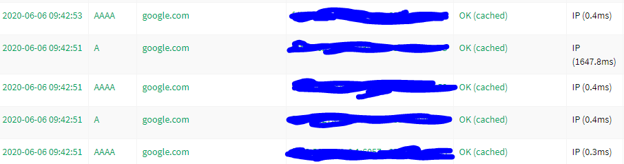

I expect all DNS queries to be answered almost instantly. I am using a Raspberry Pi 3 Model B+ with Raspbian Lite. The Pi is connected through a couple of switches on ethernet. I use the Pi for other things at the same time such as dump1090. I did have to change the lighttpd configs a bit to make the Pi-hole web interface work with the dump1090 web interface and other things but that shouldn't affect the actual DNS server.
About 5-10% of queries take a long time. I noticed that sometimes, it would take a long time on 'Resolving host' in a browser but other times it would load almost instantly. I opened a command prompt with nslookup and started querying the IP for google.com and sometimes it would either time out or take a second or two. Most of the time it was instant. I found it in the Pi-hole recent queries log:

It is unusual that you'd see response times of well over a second for a cached lookup, they should be answered almost instantly.
For my Zero, cache response times for the last 24 hours average at 5ms, and that's only due to a few peaks where it took about 100ms with the majority of lookups completing in <1ms.
If I recall your previous debug log correctly, it didn't reveal anything that would directly hint at a cause for this.

I checked htop while repeatedly querying for google.com and it shows that there was only around 20% CPU utilization so doesn't look like an issue with high CPU load.

I showed it in the video I linked. I had htop running on the left hand side and the dns queries on the right. You can see the slow query without any change in CPU usage. It was actually less than 20%, more like 10%.
