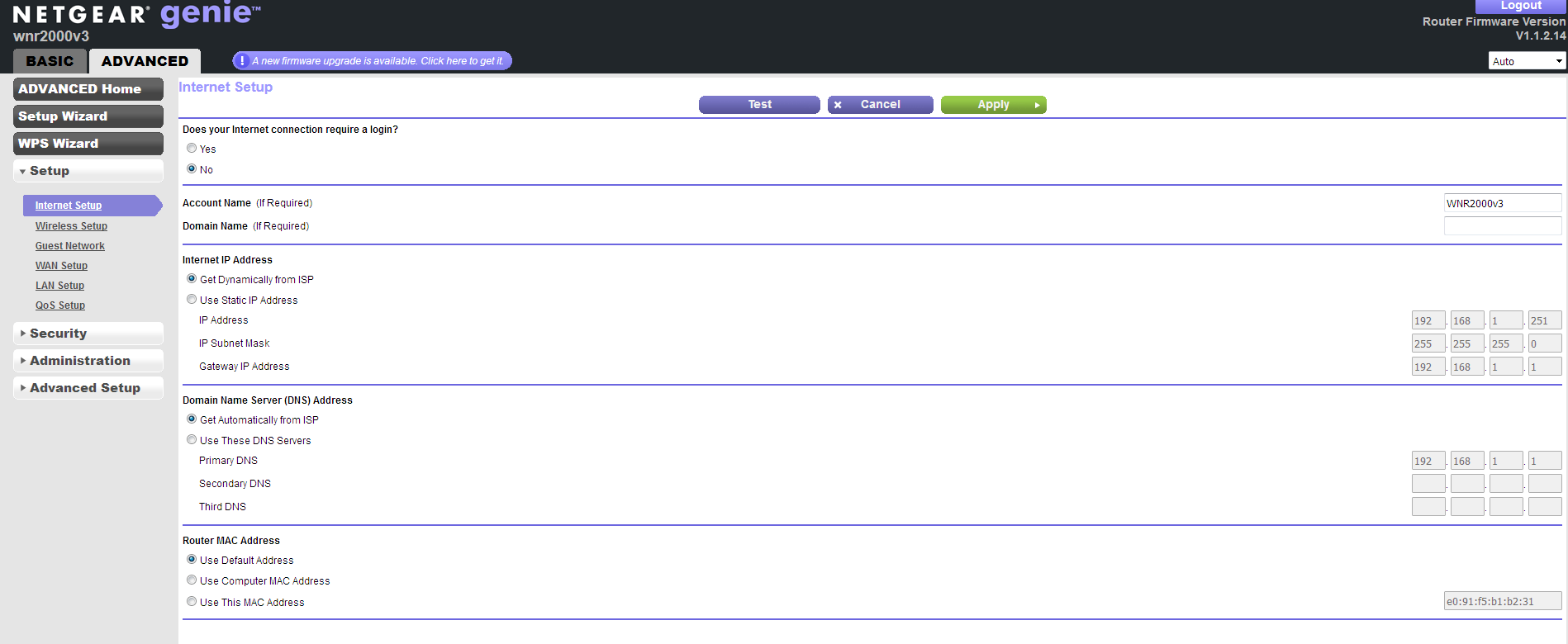

On my Netgear router, DNS settings are placed under the WPS Wizard>Setup>Internet Setup section. This page does NOT contain the DHCP settings.
DNS has always been set to "Get Automatically from ISP". When I change this to use Pi-Hole at 10.0.0.253 (and nothing else) I lose all internet connectivity. I can open Windows CMD and ping 10.0.0.253 no problem.

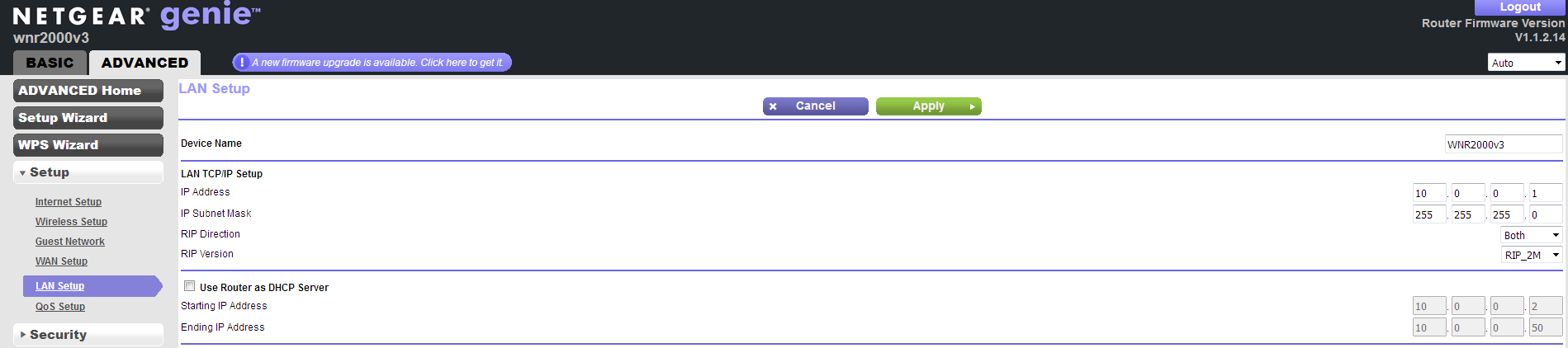

I then try to use Pi-Hole as my DHCP server. On my NetGear Genie I go to WPS Wizard>Setup>LAN Setup and disabled DHCP. My router WAS proving IP address is a range of 10.0.0.2 to 10.0.0.50.

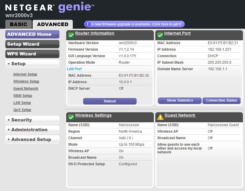

Thank you for your response Mcat. On the first issue with the DNS settings, my NetGear router and Genie interface has this under Advanced Tab>WPS Wizard>Setup>Internet Setup. This WPS Wizard section also has Guest Network, WAN Setup, LAN Setup, and QoS Setup, but all DNS settings are under the Internet Setup section. DNS also is summarized on Advanced Home page in the router under "Internet Port".
The LAN Setup section per the above is where the LAN TCP/IP Setup and "Use Router as DHCP Server" menu is located - separate from any DNS settings, which are on the Internet Setup page.

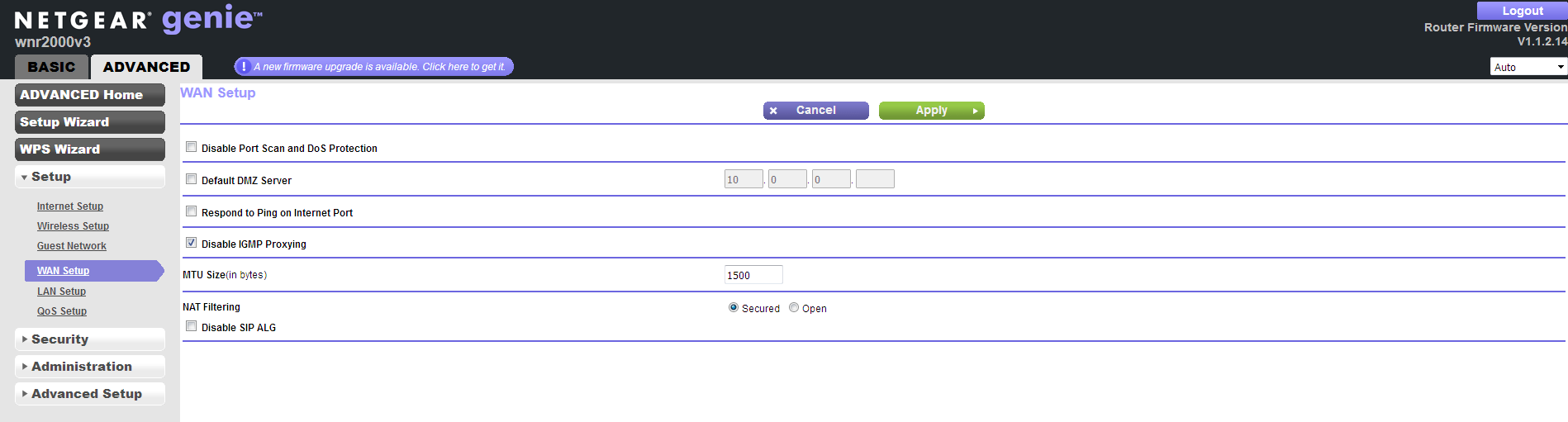

Here's the summary page:
Here's the internet setup page:
WAN setup:
LAN Setup
Not sure these images are getting pasted....
From looking at your screenshots, I'd say you cannot hand out the Pi-hole as DNS server through DHCP using your router. However, there shouldn't be any issue with just using the Pi-hole DHCP server as the features you mentioned (block specific sites for specific clients or set service availability) are things you set up independently on your router. They won't be affected by the DHCP leases being handed out by the Pi-hole.

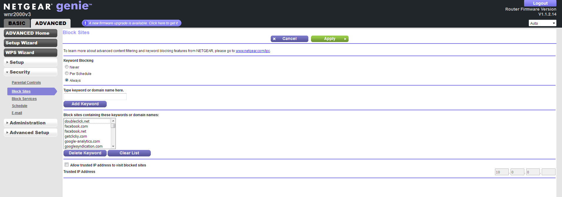

As for fully blocking access to certain domains/websites (Facebook) my router used to handle that. In fact, I had found extensive lists online to add to the Router to block advertising. This was how I previously filtered ads until I starting testing Pi-Hole.
But with the Router configured to not support DHCP, it seems like it does little of anything anymore. I can now easily access Facebook despite it being in my router list (as seen below). So since my router is no longer blocking sites, I assume it is also no longer managing schedule access, etc.

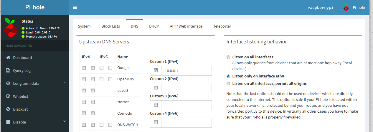

  • Go to Pi-hole's settings page and untick all Upstream DNS Servers (see the DNS tab) and put in the IP of your router under "Custom 1 (IPv4)" and click Save

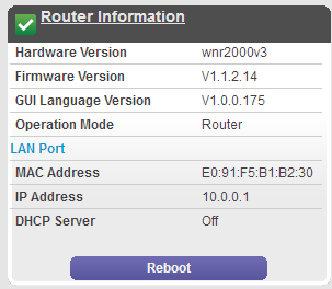

I loathe to ask this question because it makes me look like a total newbie
How do I do this? Not that deHakkelarr or DL6ER did not try to help - I just can't figure out how to enter the IP address of my router in this section on Pi-Hole.
My router address is 10.0.0.1 as per below

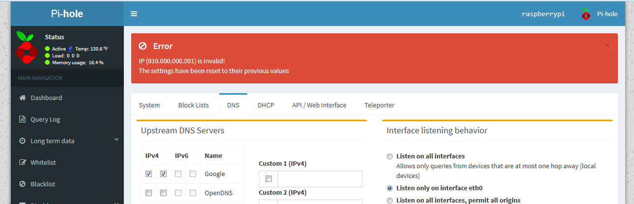

But Pi-Hole, under the DNS tab, in the "Custom 1 (IPv4)" box requires 3 digits each, not the one or two characters displayed above or whenever I use ipconfig, etc.
Unlike the problem I had previously, this will not let me enter a two-digit '10' or anything. Each field must be three digits. And it rejects 010.000.000.001
Thanks everyone for their patience on helping me with something so basic!
Please try 10.0.0.1 without the leading zeroes.
I got it - I was trying to TAB over to the groups of 3 digits. I also tried clicking on the 3-digits sections with my mouse - that also would not work. Finally, if I just typed 10.0.0.1 what I get is 100.001.---.---
What DID work was using the SPACE bar.
Yeah, we've heard varying success with this library in the past. You got the wrong impression that there were groups, because in fact there is only one text field which is filled with the word "..."
For me, fullstop works fine, but I'm glad you found a way on your system.
