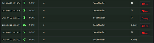

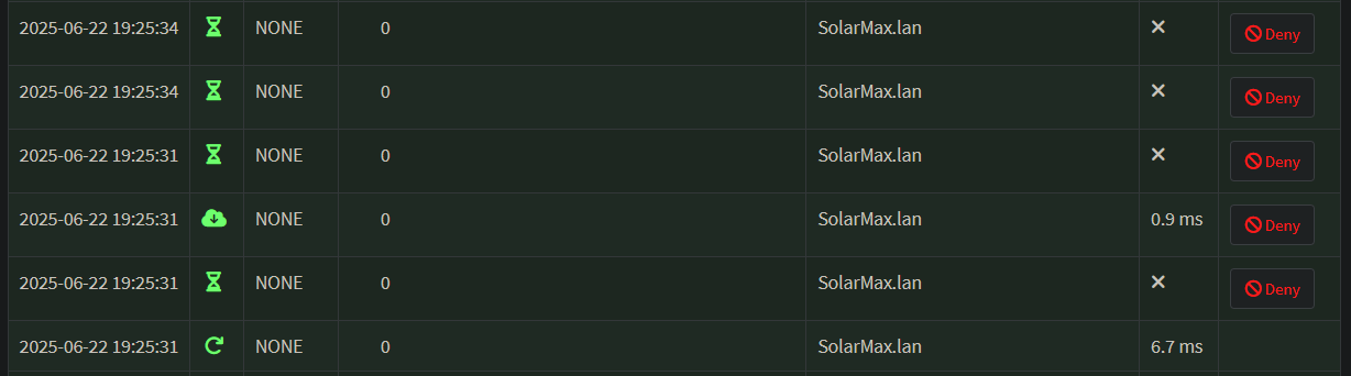

I have a misbehaving IoT device on my network that occasionally sends a malformed DNS query. Because I have Conditional forwarding enabled on Pi-hole, it gets sent to my router and stuck in a loop until rate limiting kicks in. My usual workaround is to manually block those queries, but in this case, since it's malformed, I have no idea what to block. The deny button in the Query Log fails with Timeout or Network Connection Error! when I try to block it.
The query itself appears in different formats depending on where I'm looking at it:
  • The Query Log tab shows it just as "0", but if you copy the text, it copies as "0" (Please copy paste that text to see the actual output. The browser doesn't render it) .
  • The Top Permitted Domains on the Dashboard page shows it as "%01%02%100".

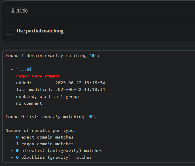

Unfortunately, the ^...0$ regex didn't work. It's weird because when I test it under Tools > Search List, it correctly detects the query using regex, but the actual query was still not blocked.
I'm now trying ^%..%..%..0$, as it matches %01%02%100.
In your screenshot the query type is listed as "NONE".
There is more wrong with these queries than the malformed domain name.

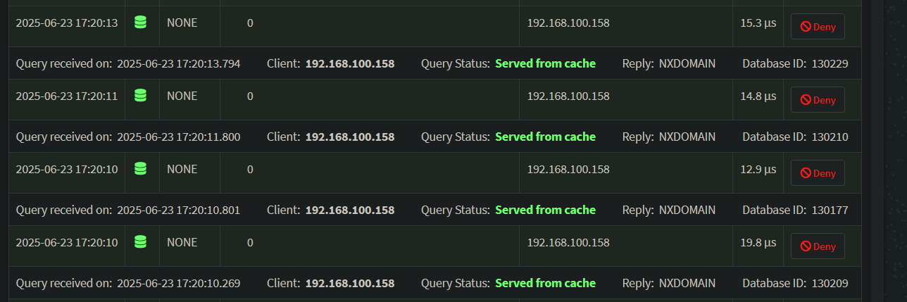

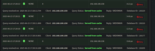

It seems like enabling Never forward non-FQDNs does stop Pi-hole from sending the malformed query to the router. On top of that, it looks like once the IoT device received an NXDOMAIN response, it stopped making the query!
Thank you all for the help :folded_hands: I will continue to monitor this and if anything changes i will post an update
