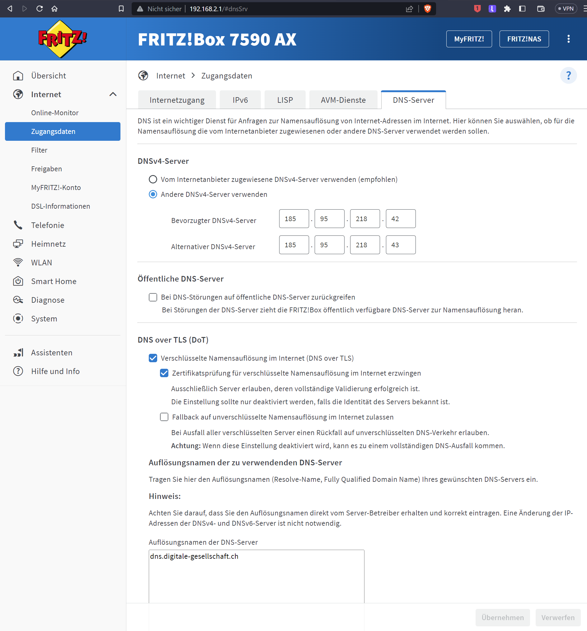

My FritzBox is using DNS over TLS (DoT).
I have configured to use following DNS Servers: Öffentliche DNS-Resolver - Digitale Gesellschaft

You could check how Pi-hole answers allowed domains like google.com as well.
If that returns as expected, reconfigure your router and run all four nslookups again.
Wait a moment.
I thought (and as I now this was the way it worked for long time) that the Pi-Hole uses the FritzBox as Upstream and the FritzBox uses the Upstream DNS from "Digitale Gesellschaft".
Now you say that the FritzBox should use the Pi-Hole as Upstream.
What Upstream does the Pi-Hole use then?
In addition here are the configs of both devices:
