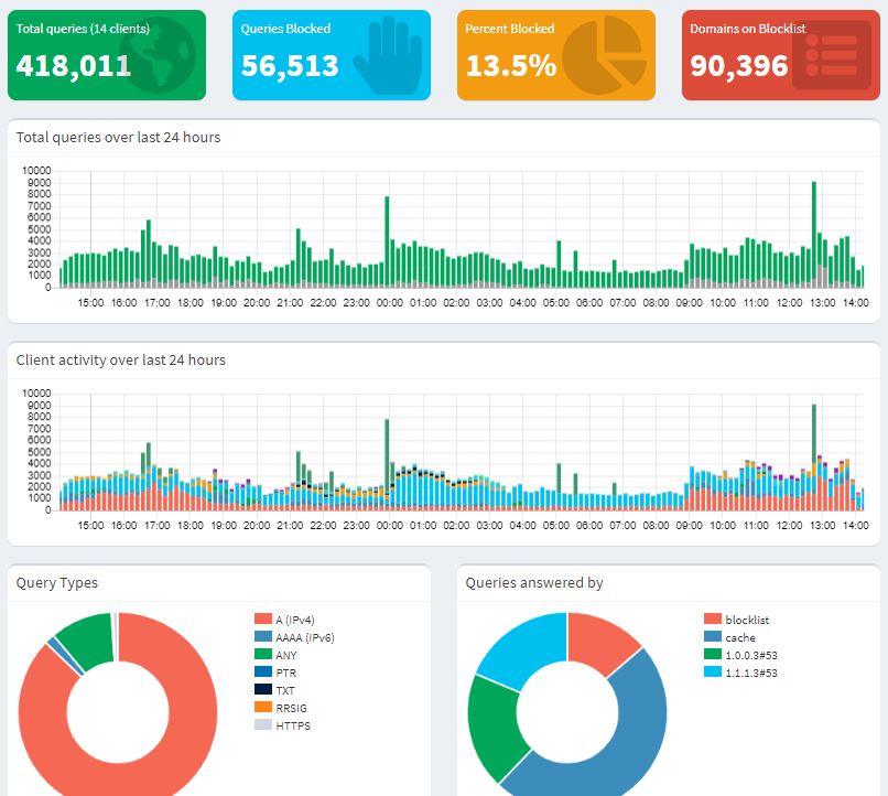

I would like to share my piehole performance and I wonder if My setup can really handle what i am giving , as I am connecting around 4000 users through 14 Routers to my Single Piehole - please Advice me if there is anything i am Missing ?

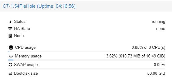

I am using Piehole on Centos7 on Promox .

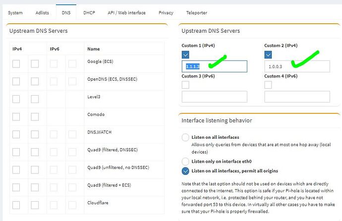

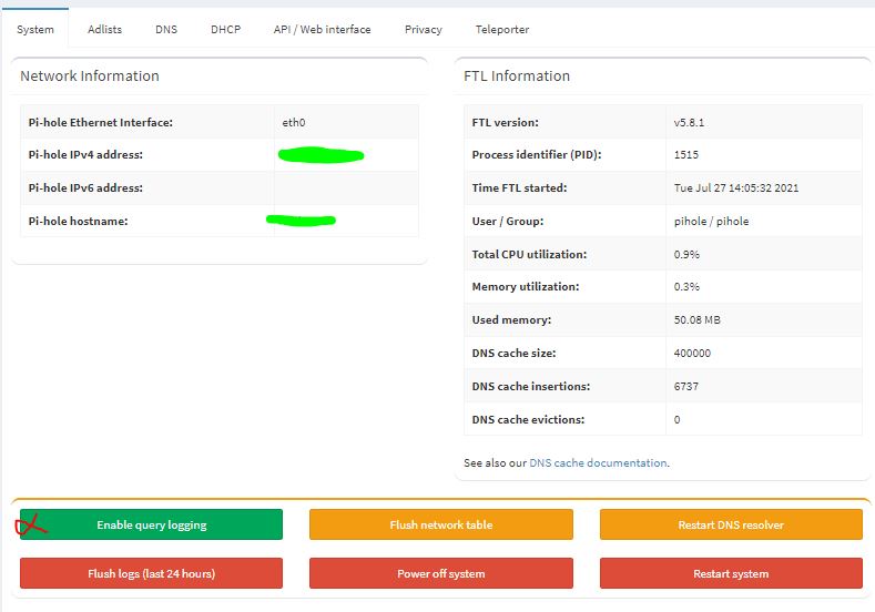

  1. I increase my DNS cache size: 400000
  2. I added a blacklist for adult filtering which is :
    `https://raw.githubusercontent.com/chadmayfield/pihole-blocklists/master/lists/pi_blocklist_porn_top1m.list
  3. I used 1.1.1.3 Cloudflare server - as an upstream dns I hope that is not a bottle neck !
    4.Listen on all interfaces, permit all origins in interface listening behavior as my Piehole is under NAT !
  4. please check my screenshots . and thanks for reading and commenting in advance :slight_smile: !

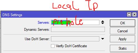

How are you controlling access to the Pi-hole? Is this being run as an open resolver, or in a LAN environment?
I am using my pie-hole local IP address as a main dns in my 14 main routers !
So all my routers + my pie-hole server are in a LAN Environment !
Do you have a similar project ?
PS : If i force all my dns (53 port) to my pie-hole I think it gets jammed some how ! and my pie hole server freezes as instead of 12 main routers query , It start getting 4000 Clients Query and that make the server kinda crush !
