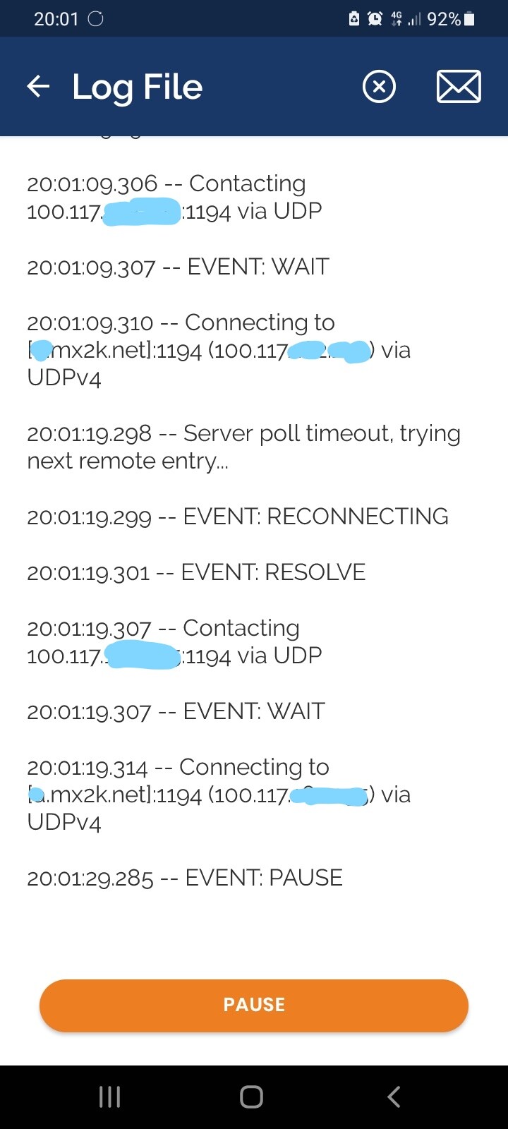

Using an Android 11 cellphone, I can connect to my DynDNS Domain/public IP running the OpenVPN server only from inside my WiFi, but not external via mobile networks.

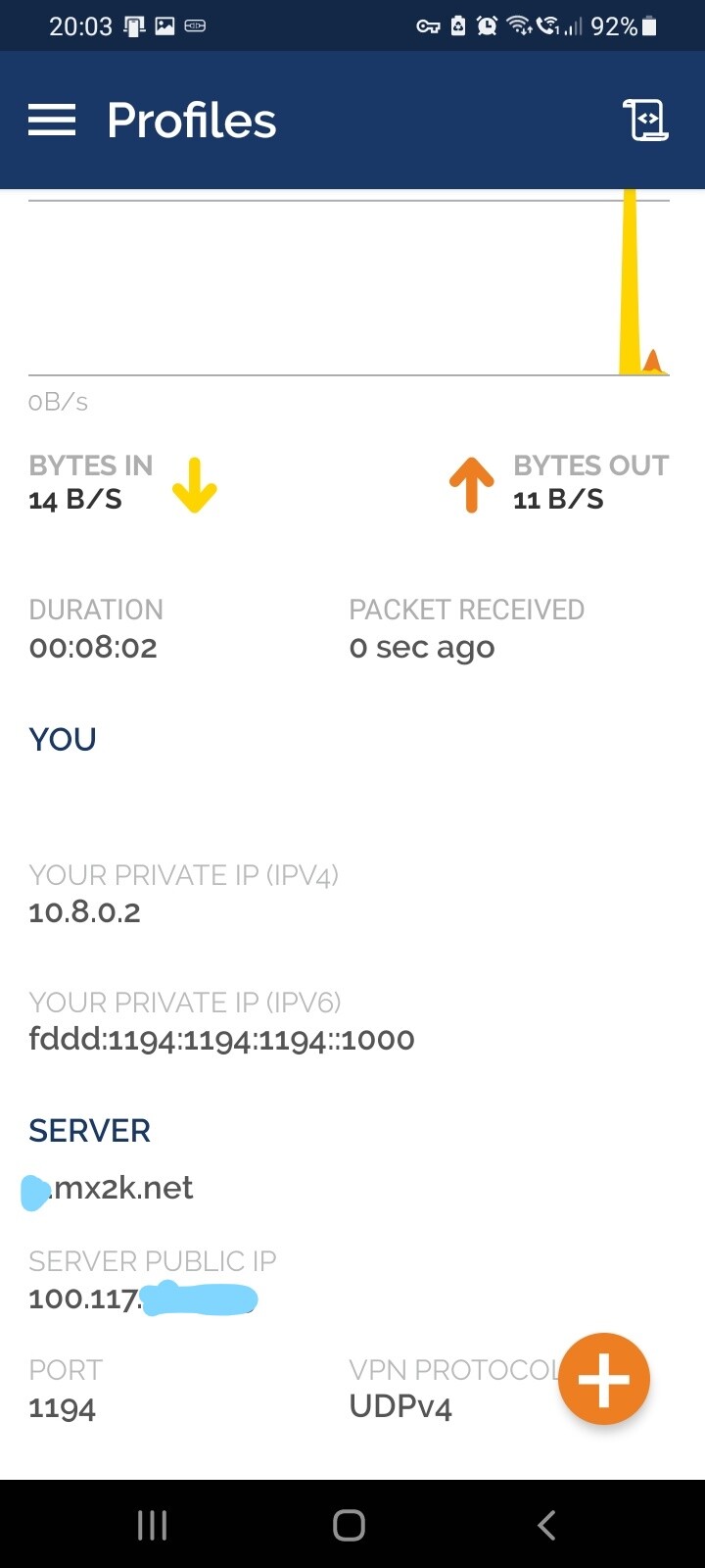

VPN connection via cellphone in my local WiFi is working.
From mobile / external networks it just times out!

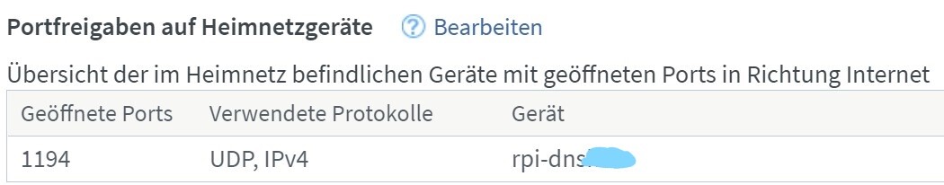

Anyone any idea on where to look next about why this is happening? My googled tech expertise is telling me, something is not letting data through my open/forwarded ports.

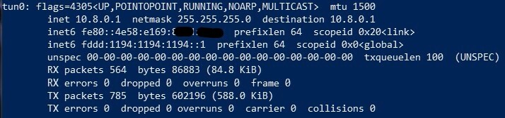

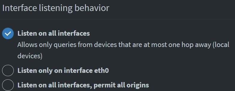

Pi-Hole is set to listen on all interfaces, and as you can see below, it sends data through the tunnel interface, at least when I connect to the OVPN server from local Wifi.
The tunnel interface tun0 is up and running.
Internet facing port wide open:
Hello,
I think I have found the issue. My ISP is not providing a public IPv4 Address. Seems I have to switch all over to external IPv6 access.
