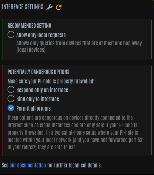

I am running v6 on RPI 5 with aarch64 Pi OS Bookworm.
I have interfaces wlan1, lo, wlan0,eth0 and tailscale0 connected, yet only requests from lo and wlan0 are answered. During initial v5 setup I selected wlan0 as my interface.
Now i have Interface Settings set to: Permit all origins
It also appears strange to me that after Bind only to interface no interface is listed.
In Settings<General the primary ip is coming from eth0.

I am still wondering why there is no interface displayed after Respond only on interface(image in original post)
I still need to set it to Permit all origins for request on my tailnet as otherwise i get the error that the device from the tailnet is a non-local device.
