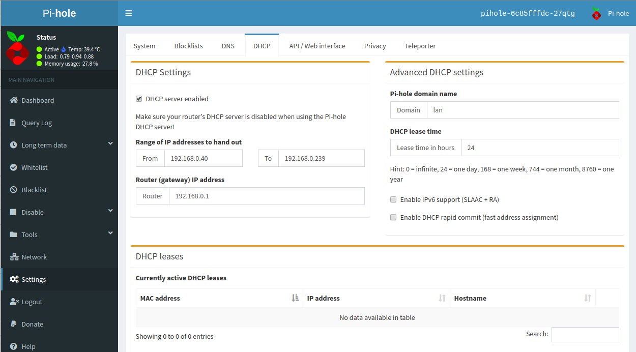

Then I disabled my router DHCP server and enabled Pi-hole like this:
I have personally no idea how to debug this with my poor network skills.I have generated the debug log tool which should give more insight: https://tricorder.pi-hole.net/it9oh5facl
