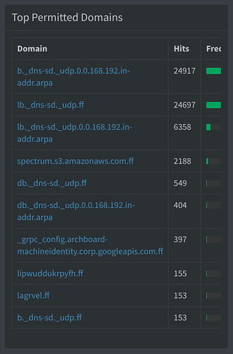

My Pi-hole has tons of random PTR queries that end in my LAN domain (.ff). This image shows the last half an hour:
I cannot figure out why something like "spectrum.s3.amazonaws.com" would be given my LAN domain --> " spectrum.s3.amazonaws.com.ff"

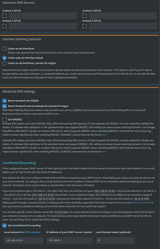

Pi-hole setup:
I have "Conditional forwarding" currently turned on but I have "Never forward non-FQDNs" and "Never forward reverse lookups for private IP ranges" turned off.
I have specified a domain of "ff" on the pihole.

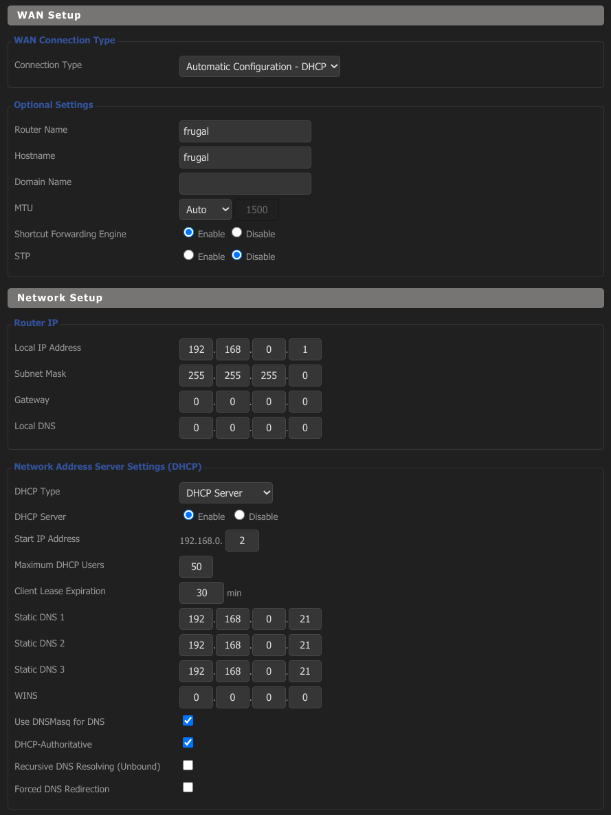

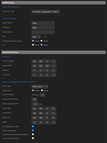

DD-WRT setup:
DNSMasq is turned on but is using Pi-hole as its DNS server.

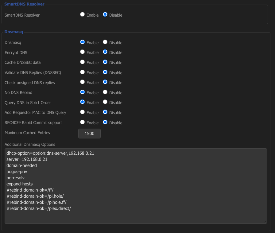

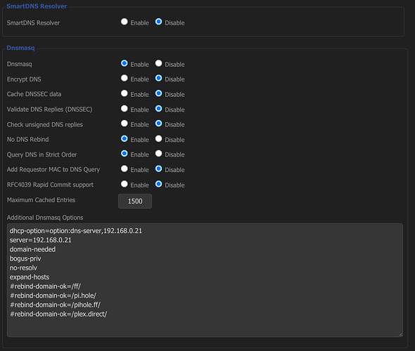

Additional Dnsmasq Options: (I could use some help with these if they look wrong)

That's normal behaviour - DNS searches routinely expand the domain name search by the local search suffix (ff in your case), see also existing posts like External Domain Queries - #5 by Bucking_Horn
Golly. I fixed it rather easily. It was my router dnsmasq options. server=192.168.0.1 screwed things up. Dumping that and replacing it with local=/ff/ did the needful.
Bad:
dhcp-option=option:dns-server,192.168.0.21
server=192.168.0.21
domain-needed
bogus-priv
no-resolv
expand-hosts
Good:
local=/ff/
domain-needed
bogus-priv
no-resolv
expand-hosts

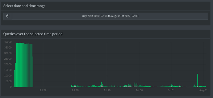

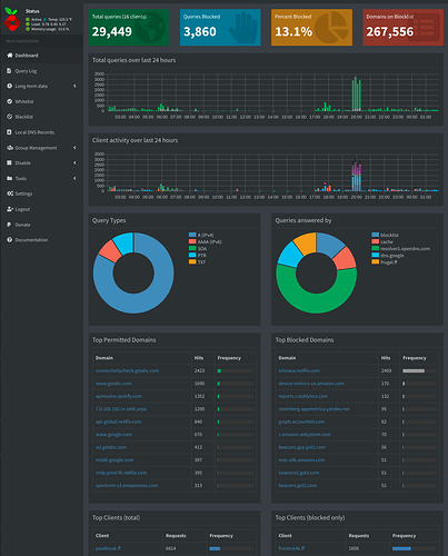

Proof:
link #1 - dashboard (if you can't see the image)
link #2 - last 7 days
link #3 - since I set Pi-hole up
