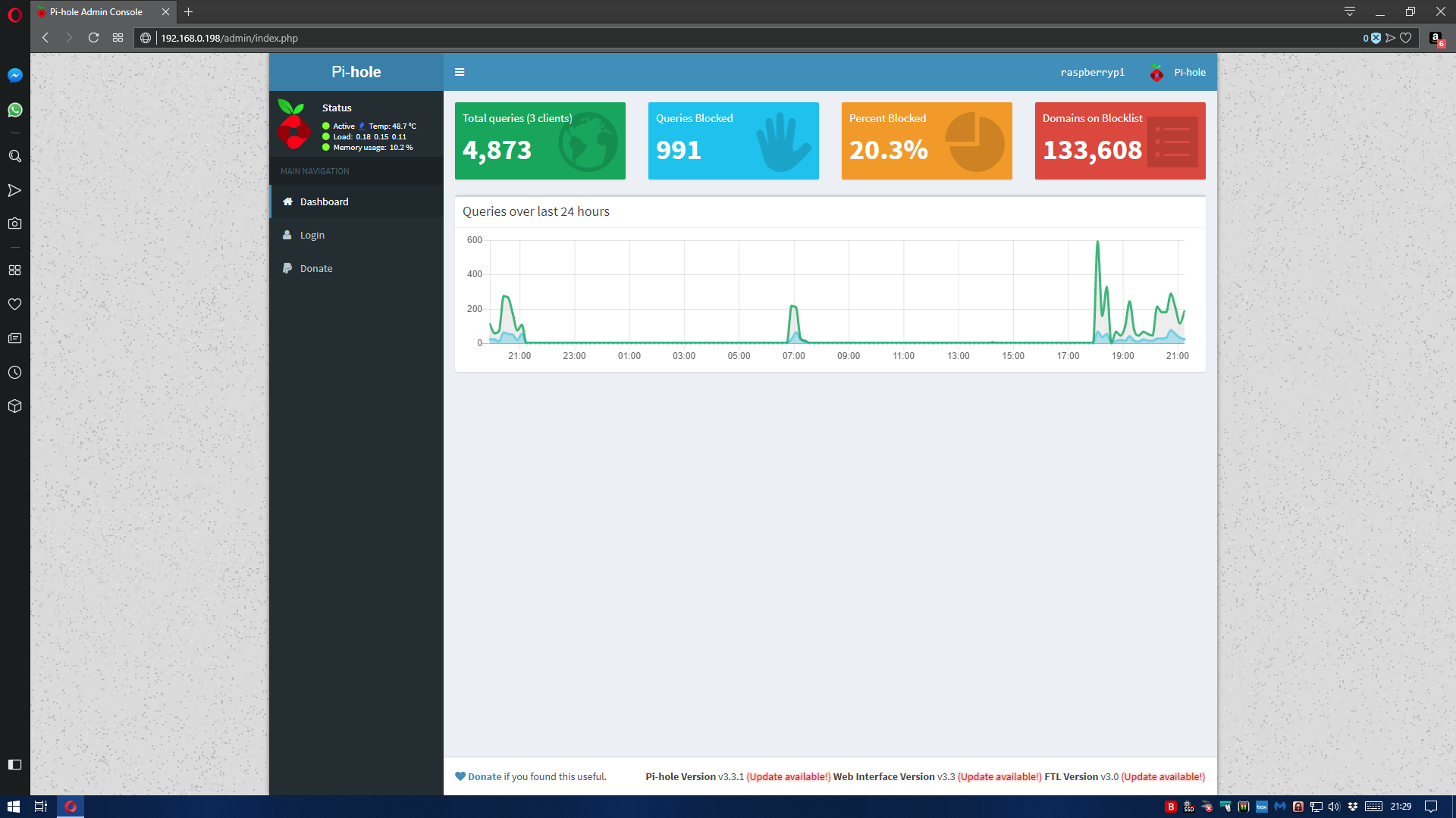

Is there a way for you to post a screenshot ?
2 screenshots attached, no screen plugged in. The raspberry pi takes power from my Xbox One S usb port and it is just then ethernet cable in to my router
