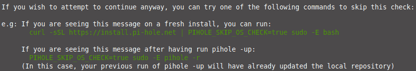

Your issue here is you are failing to pass the environment variable to sudo.
You have 2 options:
  1. use the -E option to allow sudo to preserve the existing environment:
    curl -sSL https://install.pi-hole.net | PIHOLE_SKIP_OS_CHECK=true sudo -E bash
  2. set the variable directly in the sudo command:
    curl -sSL https://install.pi-hole.net | sudo PIHOLE_SKIP_OS_CHECK=true bash

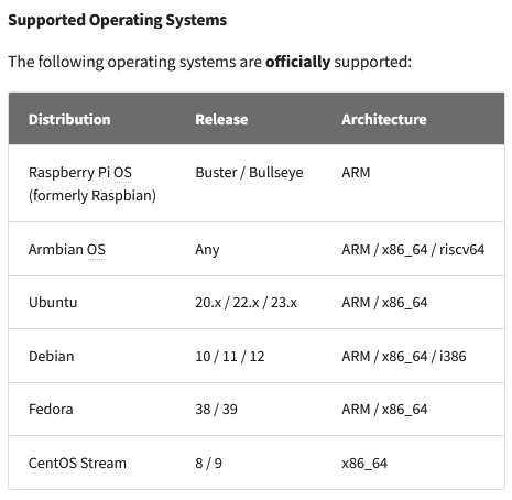

Note:
Linux Mint is not a supported OS.
It doesn't mean it won't work, but it means we never tested Pi-hole on this OS.
It also means we won't be able to verify and fix every issue if Pi-hole is installed on Linux mint.
You still can try to install Pi-hole setting the environment variable: PIHOLE_SKIP_OS_CHECK=true.
