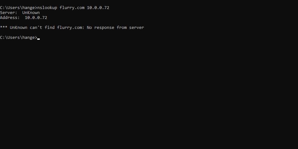

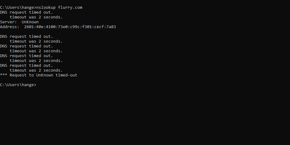

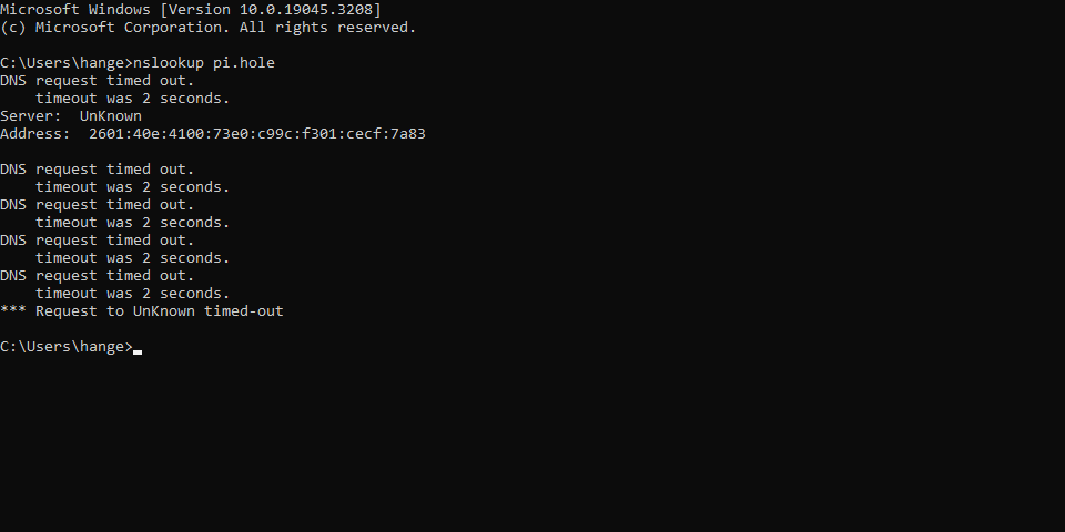

From a client that you believe should be connected to the Pi-Hole for DNS, from the command prompt or terminal on that client (and not via ssh or Putty to the Pi), what is the output of
nslookup pi.hole
nslookup flurry.com
nslookup flurry.com 10.0.0.72

nslookup pi.hole result:
nslookup flurry.com result:
nslookup flurry.com 10.0.0.72 result:

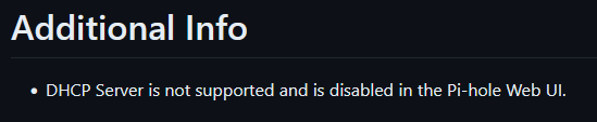

also if you need the source of what im using, it is here: GitHub - DesktopECHO/Pi-Hole-for-WSL1: Ad-blocking DNS server for Windows • Unbound pre-configured • Deployment ready in minutes • Does not require hypervisor/docker
and i notice this line,

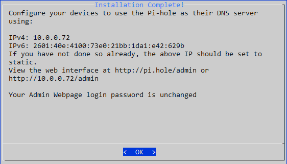

and this is the info given after running configuration.bat, my IP is static
It doesn't look like there is any support route for that version, and it's down to individuals to hack it to get it to work if they encounter any problems.
As jfb points out you have a huge load of network interfaces and IP addresses set up. Your Windows Pi-hole might be set up to use an IPv4 address and an IPv6 address, but it also needs to be able to act as a DNS server on your network so that your other clients can use it.
In your case the IPv4 addresses aren't working, the IPv6 address being used isn't routable, and there's no DHCP available to tell clients to use Pi-hole.

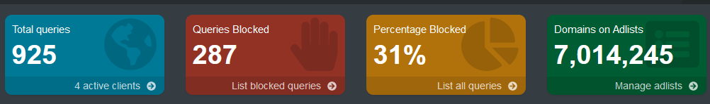

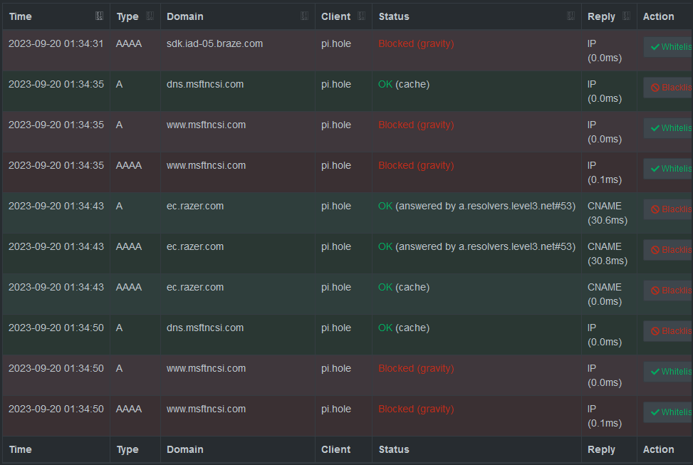

update: i deleted the old .cmd file and downloaded it again anew, after a complete uninstall, ran the file and allowed it to install with default settings, i disabled all other network devices on my setup, virtual network devices and all, and it opted to use the proper eth0 and 72 ip i specified. I also opted to use level 3 DNS instead of cloudflare, and that's the only thing i changed, so i believe that may have been an issue, for whatever reason.
set the ipv4 dns on my phone and computer itself, and results are being shown and filtered.

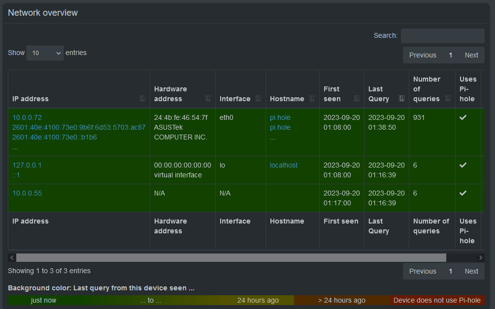

The only oddity is that my pc is listed twice, as localhost and pihole, aside from that those 2 + my phone are listed as clients, yet it says 4 here
looking in the network tab there are only 3
Regardless, total wipe and reinstall + level 3 dns seems to have fixed it, for now at least.
That's actually normal, localhost is the machine on which it's installed via the loopback interface, while pi.hole is a custom name internal to the Pi-hole via the configured address. From the point of view of the machine running Pi-hole, both are valid routes to and from the Pi-hole services.
