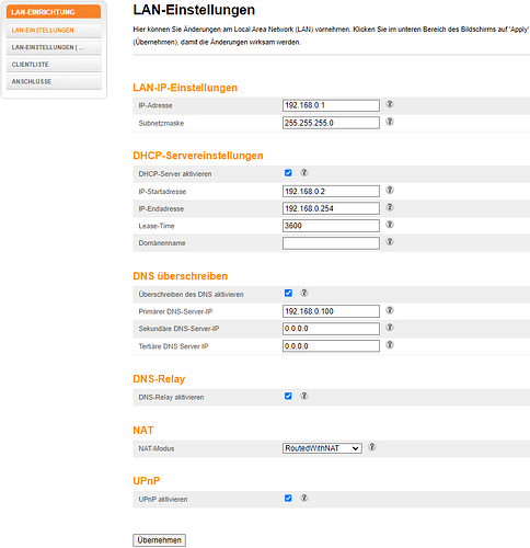

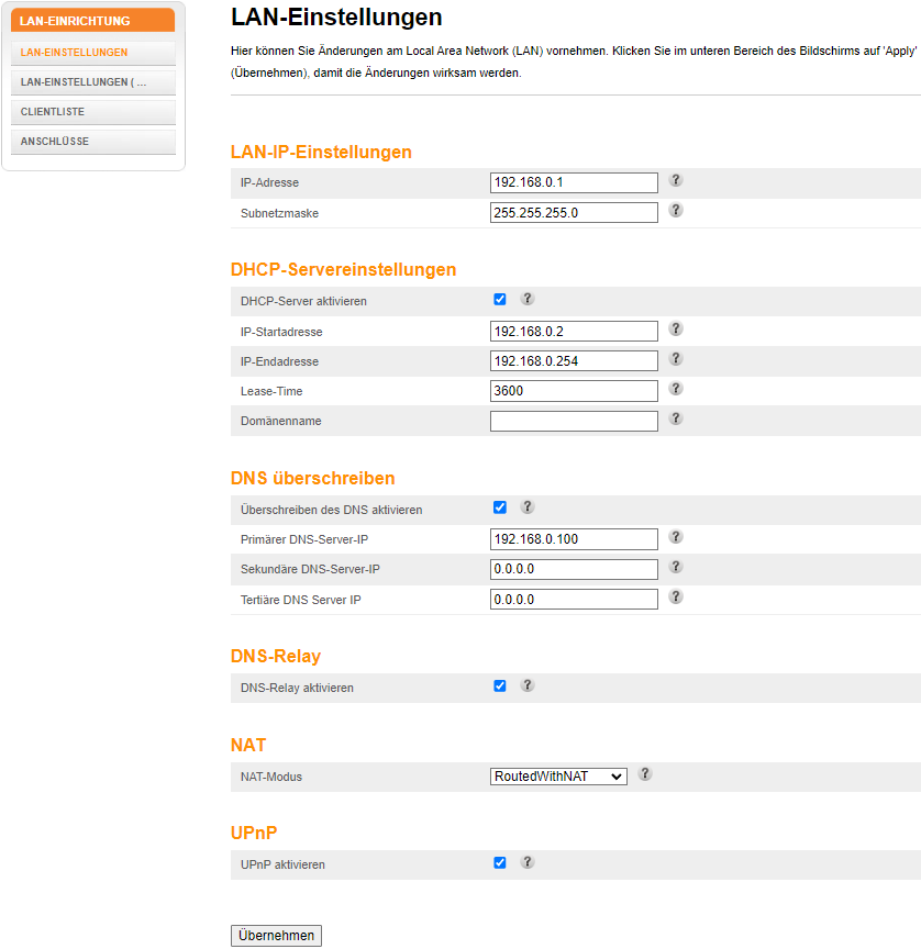

I receive the same output with my setup in my router where I set the DNS-Server to my pi (Picture 1) and when I try to directly set the server in my network adapter settings (Picture 2).

Thanks for your reply. I checked and can't find an issue. More information about what I tried is in my reply to jfb. Maybe you read something out of it or spot a possible mistake
What about IPv6? This is usually autoconfiguring itself and DNS via IPv6 (resolving for v4. and v6!) points to the router found by router advertising.
To test, you could disable v6 on the client for a moment.
