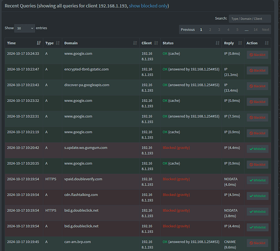

It's very strange what I'm seeing. So seems like some requests from my phone show up as blocked in the query log like these here and some are not:
But then regular requests like to https://discourse.pi-hole.net, do not show up on the non-blocked or blocked list....
While they always show up when accessed from a PC....
