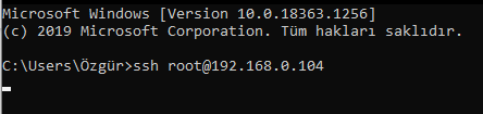

after 4 days. Pi-Hole does not resolve DNS requests. the web page is not responding.
log:https://tricorder.pi-hole.net/tcfcyrzrao
The output you're showing means there's a networking issue between the client and the Pi. You're using the IP address of the Pi so there is no DNS involved.
Futher, the debug log you uploaded shows that Pi-hole itself is working.

Your ssh failures are on IPv4 though.

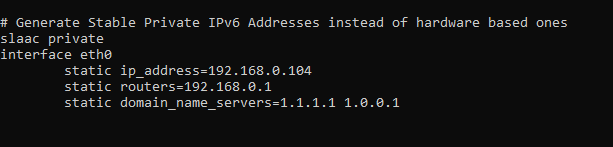

I think you need to check your networking. Are you assigning the Pi address as a DHCP client or are you doing it statically via /etc/dhcpcd.conf? The debug shows there is a DHCP server offering .104, if you have set a reservation on the router then check /etc/dhcpcd.conf to make sure you're not also setting a static IP address.

yes i have also set a static ip adress on the orangepi . i am disabling the routers ip adress binding :image
i will try using pi-hole thanks for the help
It has been 5 days and I never had a problem since. I would like to thank everyone who helped to make this awesome shoftware, and especially DanSchaper for helping me out!
