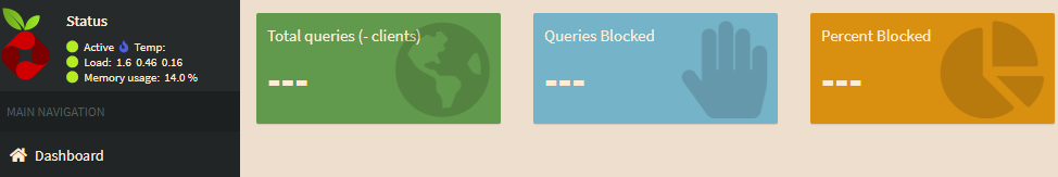

The dashboard is still not working. Not sure what the dnsmasq failures are about.

I rebooted the pi-hole, but the dashboard is still broken:
Please generate a new debug token
https://tricorder.pi-hole.net/j9unjvexht
[I removed the debug log - it might contain sensible data]
Your debug log looks fine.
You can try two things
  1. Clear your browser's cache
  2. Run pihole -r again (choose repair)
After doing both things, the query log is now fixed instead of throwing an error.
However, local DNS records throws this error: DataTables warning: table id=customDNSTable - Invalid JSON response. For more information about this error, please see http://datatables.net/tn/1
Groups under Group Management also throws basically the same error: DataTables warning: table id=groupsTable - Invalid JSON response. For more information about this error, please see http://datatables.net/tn/1
Pi-hole diagnosis under Tools is the same: DataTables warning: table id=messagesTable - Invalid JSON response. For more information about this error, please see http://datatables.net/tn/1
The overall dashboard is also not working yet. It seems like all these errors are related?
Edit: Tried this on two different browsers with the same results.

It is still not working. However the query log is now functional so that's a big step forward. Thank you for your help to get this far.
@jfb Do you have any further suggestions for fixing the dashboard?
