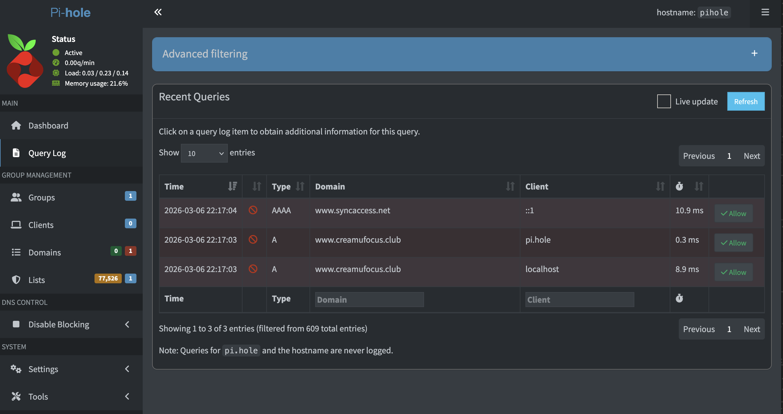

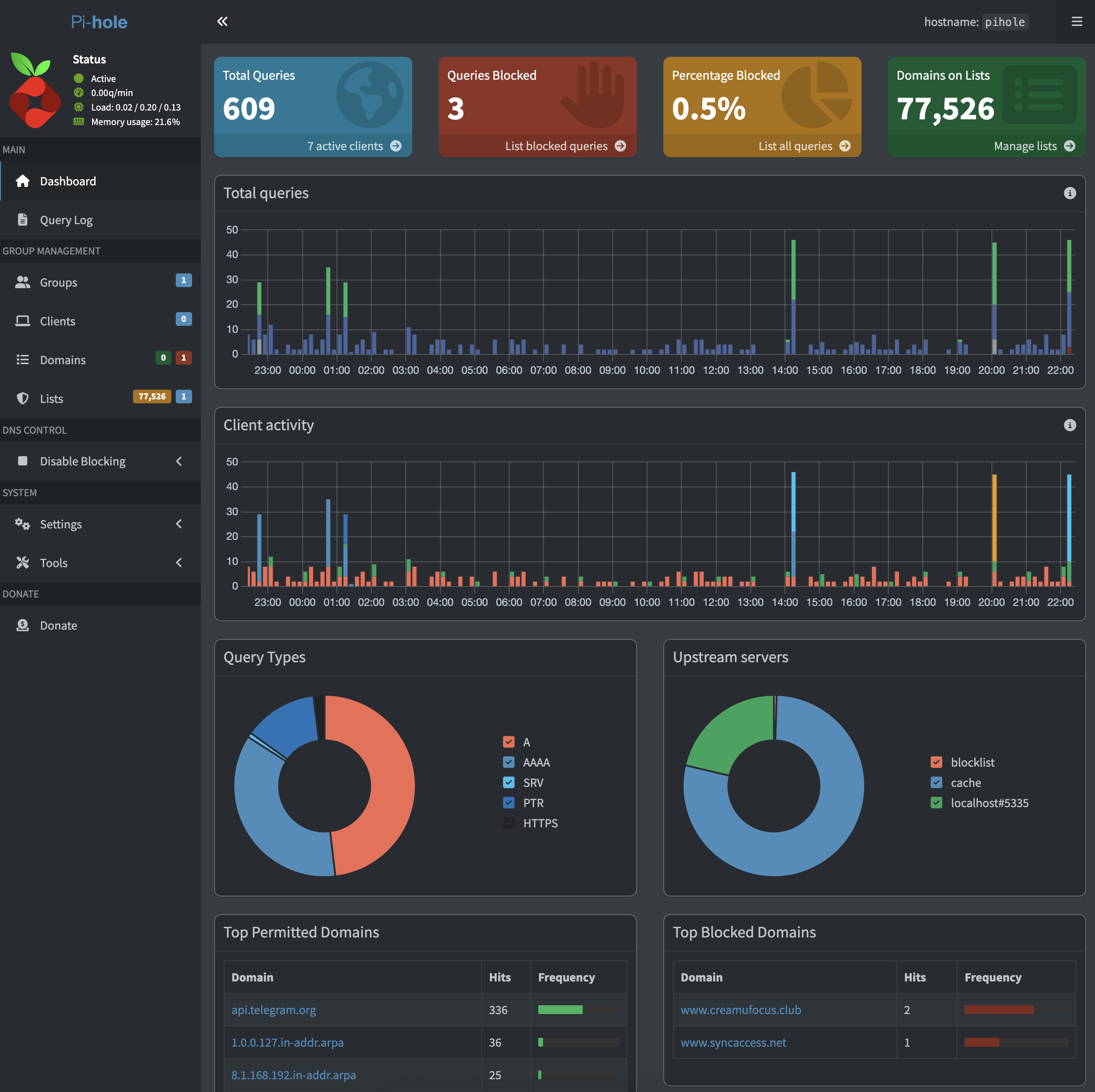

Hi, thank you for your patience and for looking into this. I went on and was busy with work for the past few days, when I came back today there was 0 blocked queries. I ran an ‘sudo apt update’ and ‘sudo pihole -r’ (is it normal that pihole required sudo?), now there’s 3 blocked queries, the diagnostics showed IPv6 wasn’t in use. Can you help me have a look please? Thank you in advance?
https://tricorder.pi-hole.net/fOL5MPAv/
Is is somehow now working altogether with tailscale connected on my devices
