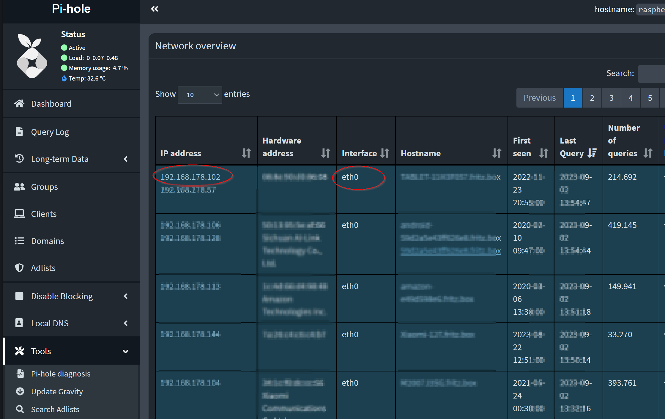

The problem: If I go to the PiHile WEB interface and look at the network interfaces (here e.g. a Windows client with the IP 102 at the end), then only eth0 is displayed by all clients. But not the WLAN interface.

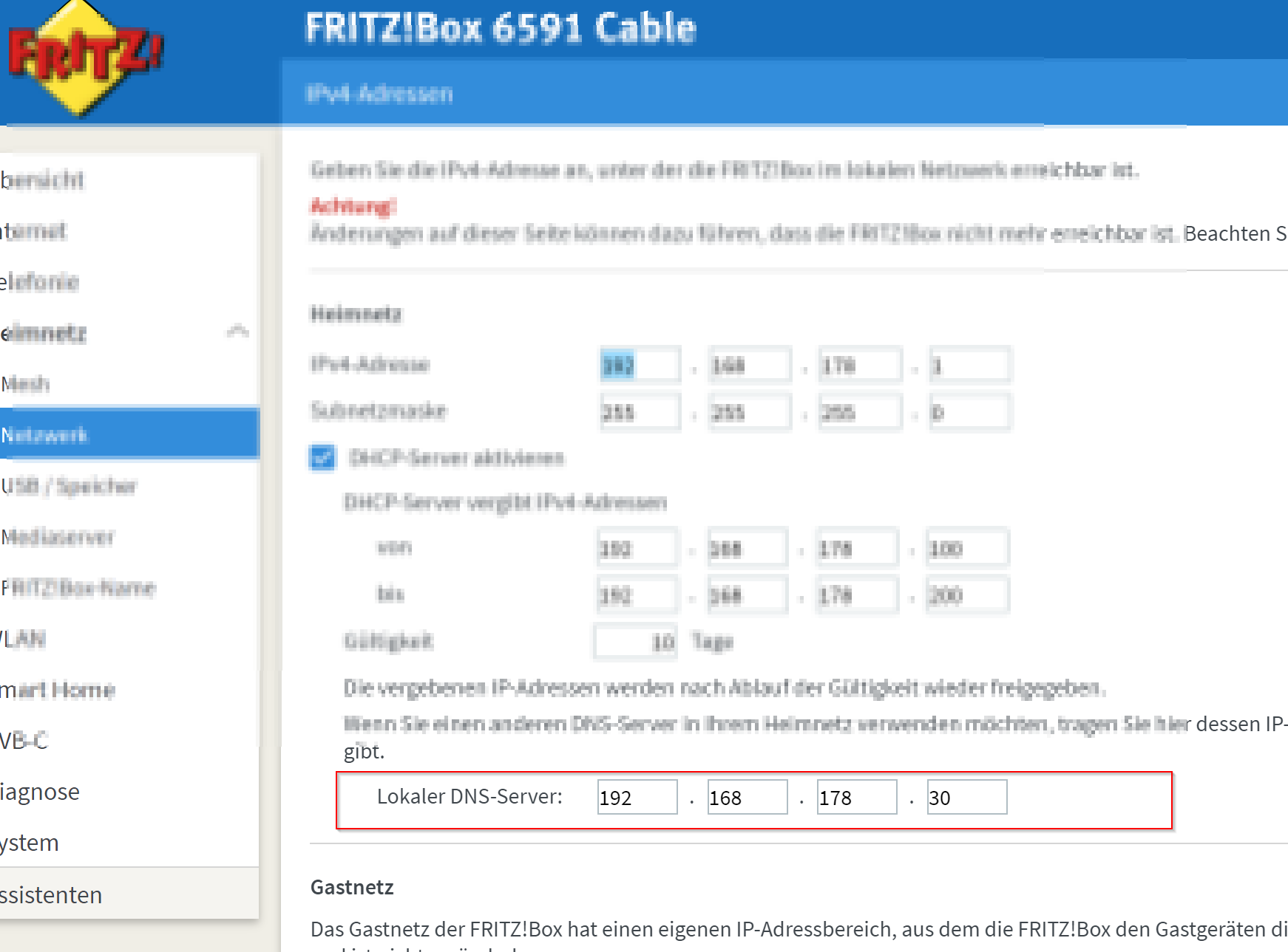

Router set to Pi-Hole :

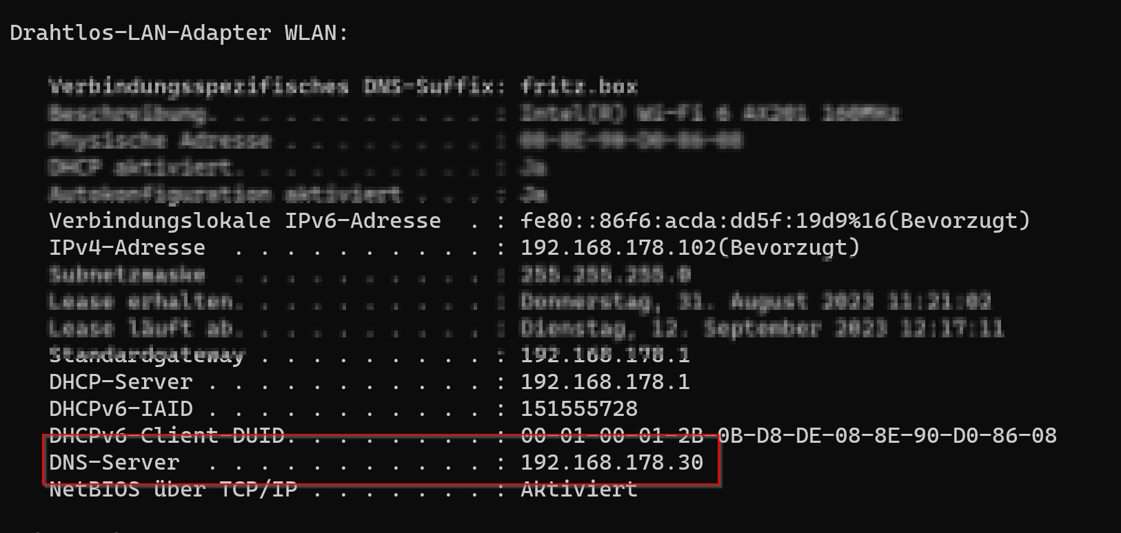

Client settings to Pi-Hole DNS:

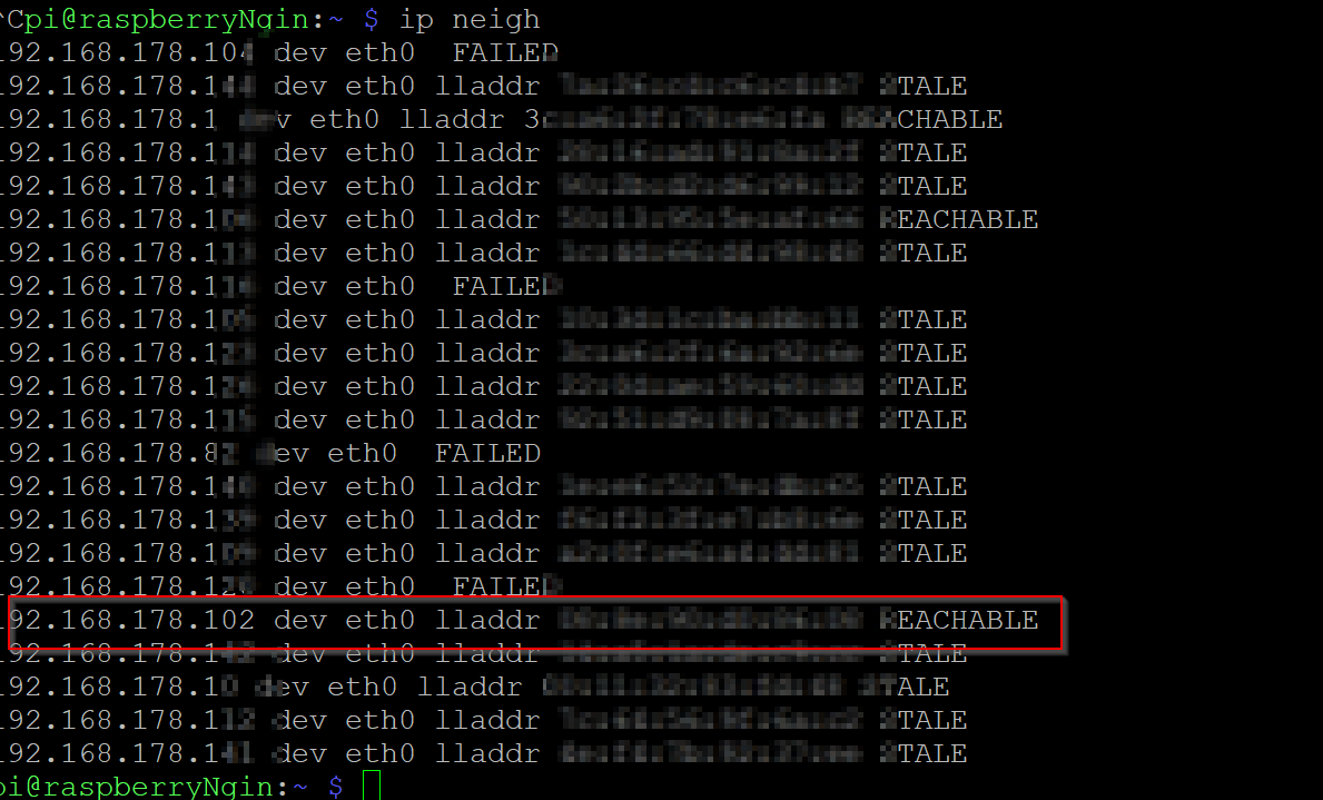

Pi-Hole neigh command lists:
Ping Pi-Hole > Client & Client > Pi-Hole getting answer. So it works without any issues.

This screen shows you the interface being used by Pi-hole, not the client at the other end. Your Pi-hole is connected via ethernet to your router, so the interface is eth0.
As your network tab shows, you are getting requests from clients using their WiFi to connect to the network (i.e. the PC at 102).
Hi and thank you. The listing is a bit confused i think. but if so, then thanks again.
