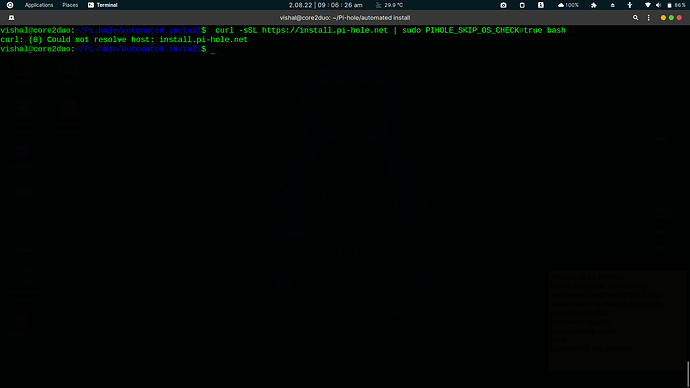

I have set up a server in order to install Pi-hole. I have configured static ipv4, but I am not able to install the Pi-hole properly, it's giving DNS resolution error.
Details about my system:

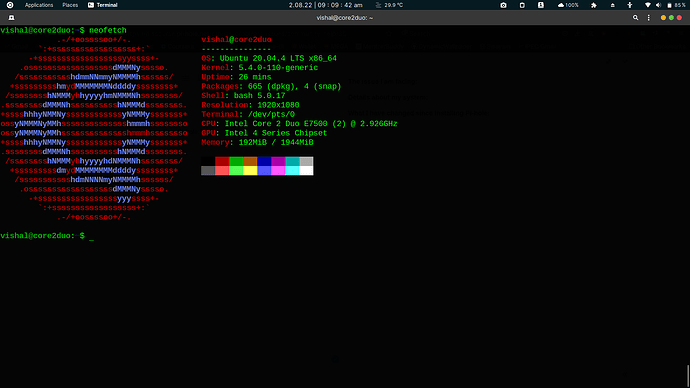

The server used is Ubuntu Server 20.04 (Image 1). And it's a fresh install, so I haven't configured anything apart from static ipv4.

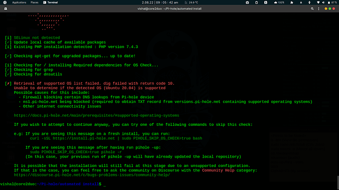

I have changed nothing in the system. After running the shell script for the first time, "DNS resolution error" (Image 2) came up and exited the installation, so I again ran the script and some other error came up (Image 3). I tried the suggested step (Image 4) but it didn't make any difference.
