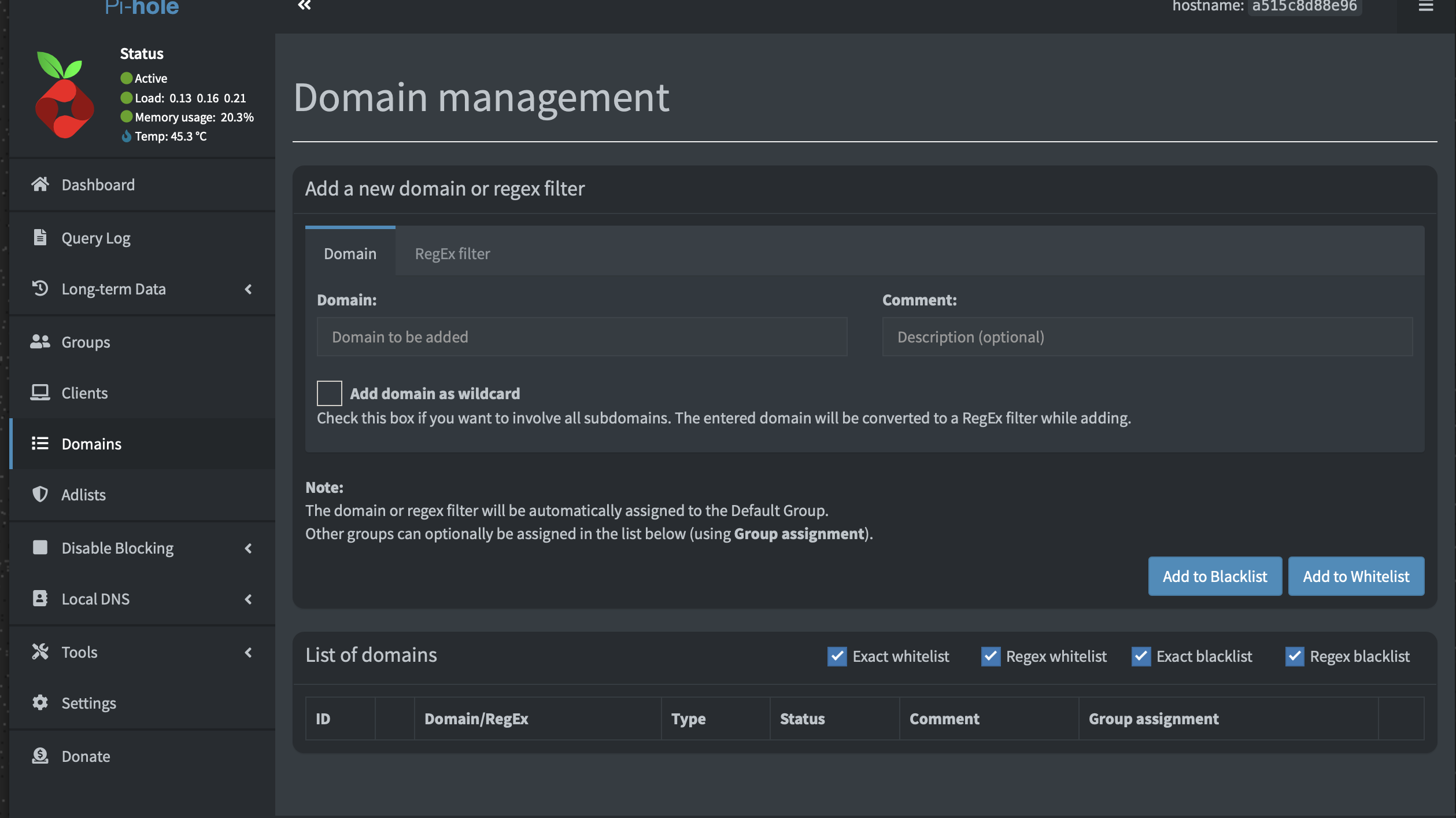

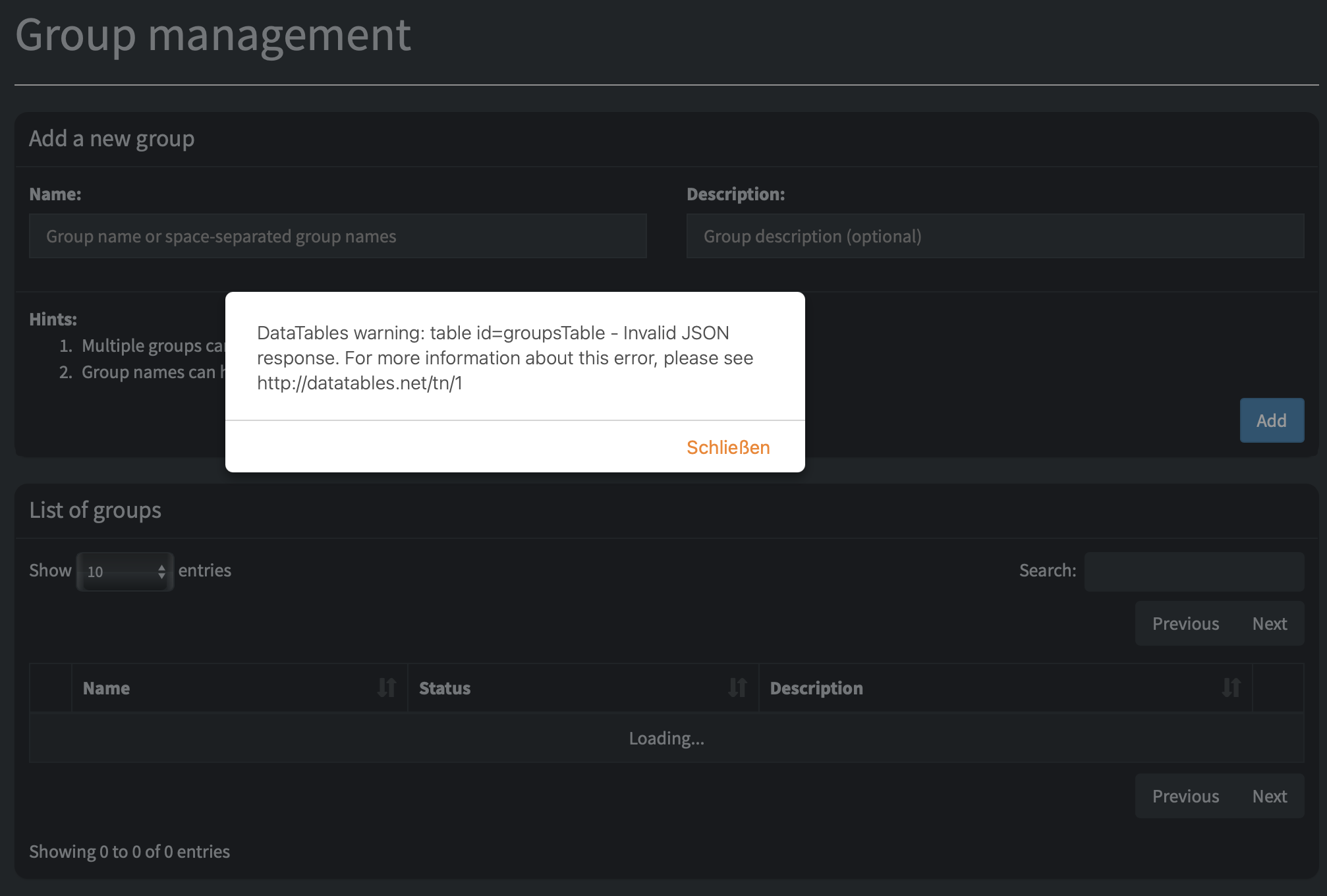

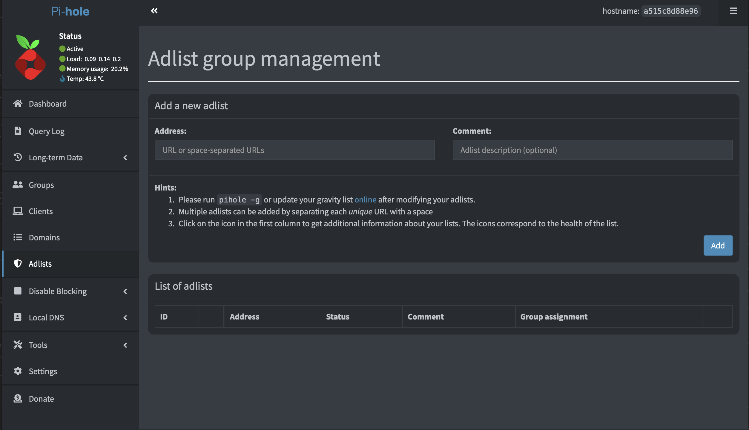

just recently checked, that my Pi-hole is acting strange when accessed through my dedicated url. All smooth, when I accessing through Pi-holes IP-address. Basically it is working, but the webfrontend does not display Groups, Clients, Domains, Adlists, Diagnosis and throws errors as well (sometimes). See attached screenshots.

I'm not sure how you configured your custom domain and your reverse proxy, but there are many CORS errors in lighttpd log.
Execute this command inside your container to see the messages:
tail /var/log/lighttpd/error-pihole.log
