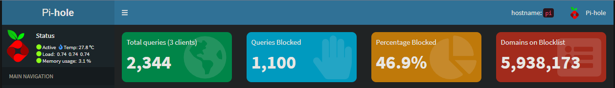

But some from other lists I think are still blocked, because the Queries Blocked number goes on....
46.9% of your requests were blocked. What domain do you expect to be blocked?

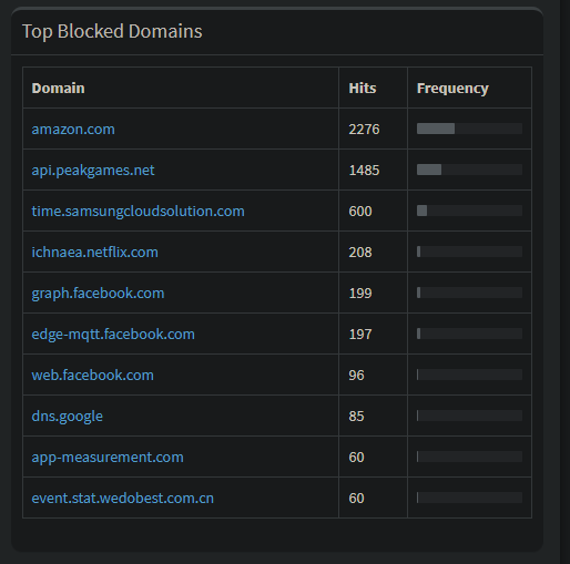

As i said, i don't know exactly what is really working, because for example the mentioned list, is active in gravity, but none of it s domains are blocked and i am still able to access them.
Also, i tried to block my domains, one by one from Blacklist, and none of them got blocked.... So i don't really know what are those 50% of blocked queries.

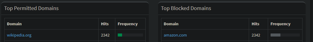

Example: I am able to access amazon.com but it got 2276 blocked hits ...
Also, no idea why the total permitted queries for Wikipedia and the number of blocked queries of amazon are the same. I never opened Wikipedia or smth on any of my devices.
