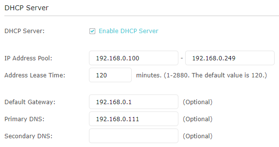

Below snapshot shows the wifi router configuration for DHCP server is using pihole as Primary DNS:

Your router's DHCP server distributes ist own IP address in addition to Pi-hole as local DNS server:
   * Received 300 bytes from wlan0:192.168.0.1
     Offered IP address: 192.168.0.111
     DHCP options:
      Message type: DHCPOFFER (2)
      dns-server: 192.168.0.111
This would allow clients to by-pass Pi-hole via 192.168.0.1 at their discretion.
Pi-hole has to be the sole DNS server for your clients.
Thank you. After updating my routers DHCP to have the PiHole's DNS as both Primary & Secondary DNS, now I see the below from the debug log. Here is its token url for reference.,
