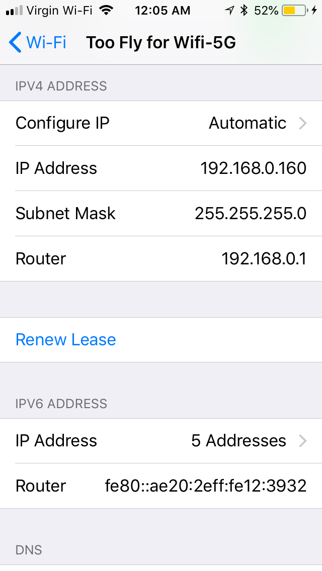

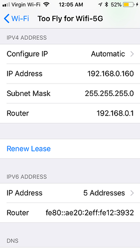

I'm not very familiar working with IPv6, so how do I check? when I look at my DNS config on my phone, I have it set to automatic and I'm getting my .4 IPv4, but the IPv6 appears to be different then my router...

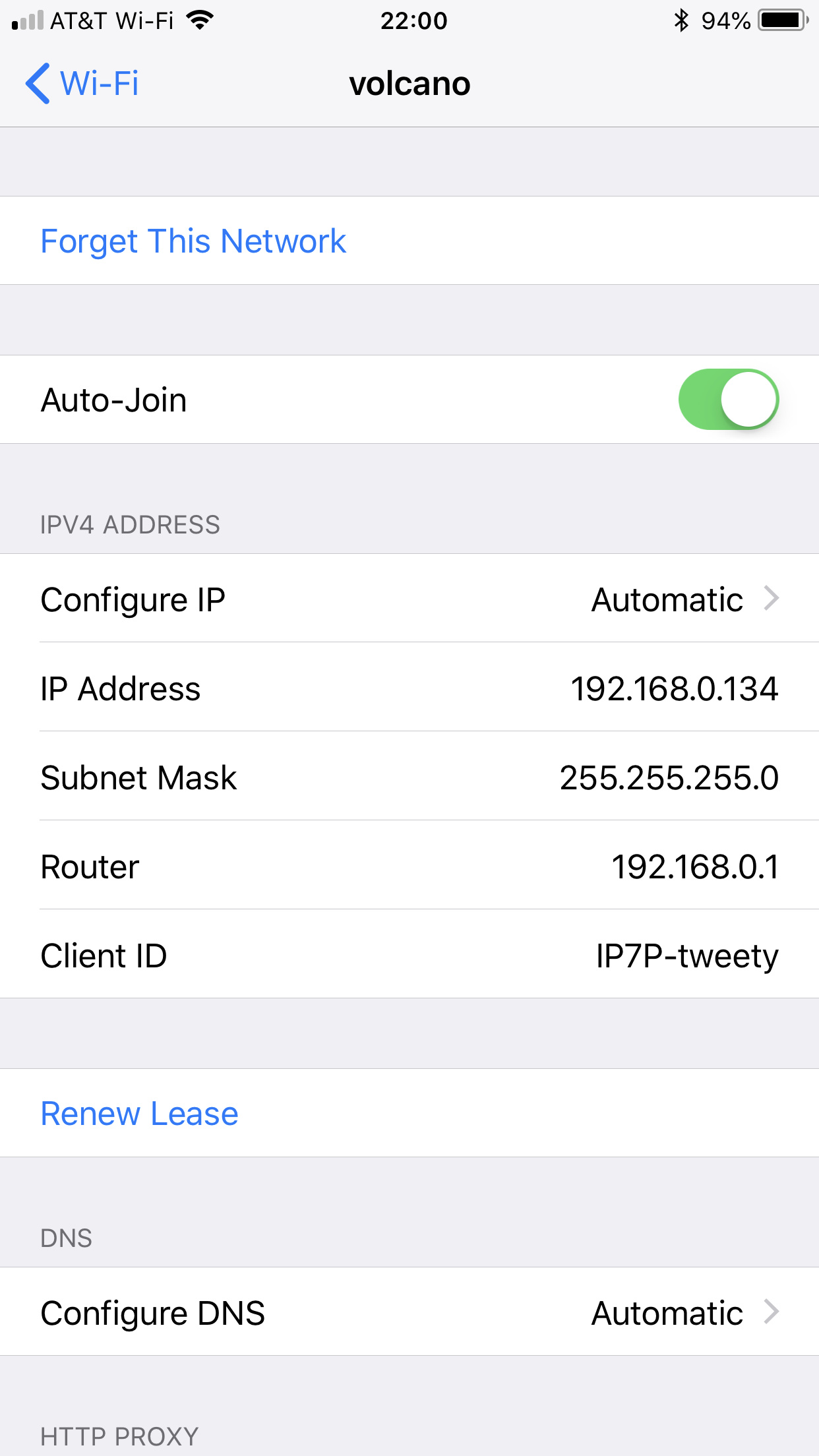

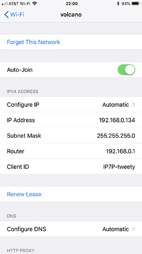

If you don't see an IPV6 address on your iPhone, it doesn't have one assigned. I have IPV6 turned off on my network, and here's my network settings page on the phone:
If you have an IPV6 address, it came from the router and it won't match the address of the router. IPV6 is different than IPV4 in a lot of respects.
Yes, I have 5 IPV6 addresses on my network. I do see that it came from my router as well... as you mentioned. I could always turn off the IPV6 Support on my router... not sure if that would be beneficial or not....
Go ahead and do that for now. You also have your Pi-Hole DCHP set for IPV6 addresses.
