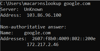

When performing nslookup on clients, the server points to "UnKnown" and the address points to some unknown IP, and not the IP of my Pi-hole.

At least 2 other devices are also using Pi-hole (192.168.1.67 and 192.168.1.210), but your last image shows a Windows client is not using Pi-hole as DNS server. Maybe it is still using the previous DHCP information.

In the pi-hole clients list all of my Windows devices show up in green and claim to be using Pi-hole, yet are not actually using it based on that last image. I tested on my laptop and my desktop and both were able to navigate to the page.
Just check your Windows devices using ipconfig /all on the command line to confirm which DNS servers are being used.
Your image shows the Windows machine is using 103.86.96.100 as DNS server.
Are you using a VPN?
Ahhh yes I am. When the VPN is disabled nslookup now points to pi-hole and everything seems to be blocked properly. Any idea how I can continue to use my VPN as well as benefitting from pi-hole?

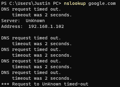

I think I've made some progress to routing traffic through the Pi while using my VPN - I set up openVPN on the pi and changed the VPN protocol to use openVPN, with the VPN's custom DNS pointing to my pi on each windows device. When I perform the nslookup command on the windows device I now see the server as my pi, but I'm running into other issues:
I am still able to access websites on the blacklist, so traffic from my windows devices are still not properly routing through the Pi.
