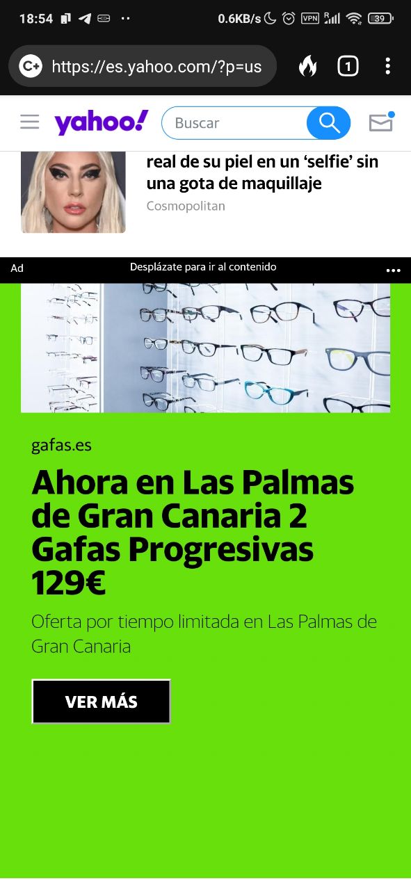

I was expecting no to see ads: I do see google ads one some websites and I see ads in Yahoo (see screenshot below)

So in my phone I opened chrome, went to Yahoo News, and I did see ads.

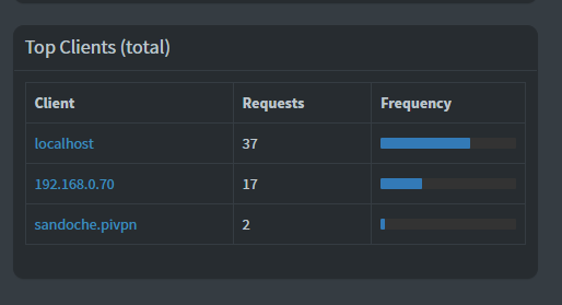

You can see in the picture below there are somehow just 2 queries for that client:
The IP 192.168.0.70 is the same device using the DNS settings in the Wifi settings.

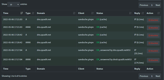

When I click on the details of the "sandoche.pivpn" I see the following:
