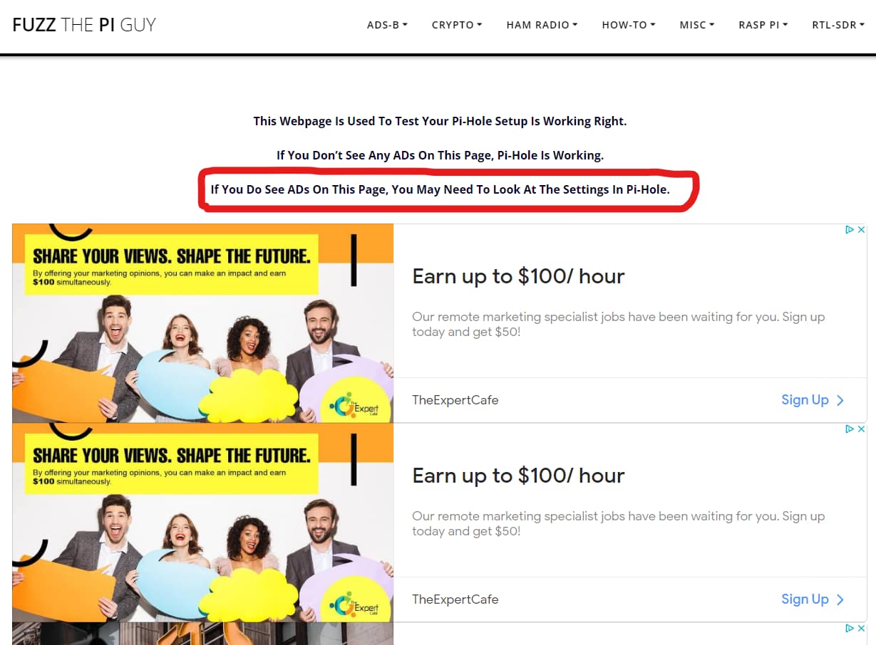

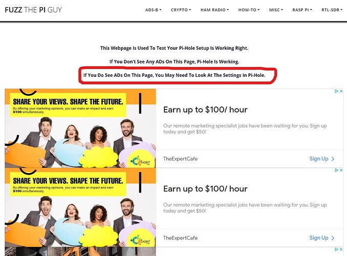

I am testing whether my Pi-Hole installation is working by testing Pi-Hole's effectiveness at Pi-Hole Ad Tester – Fuzz The Pi Guy. I see ads on the page. See attached screenshot for evidence. Please help troubleshoot and resolve.
It's not just a specific ad domain. My Pi-hole is not blocking any ads in my observation. Please help with troubleshooting or reinstallation steps.
