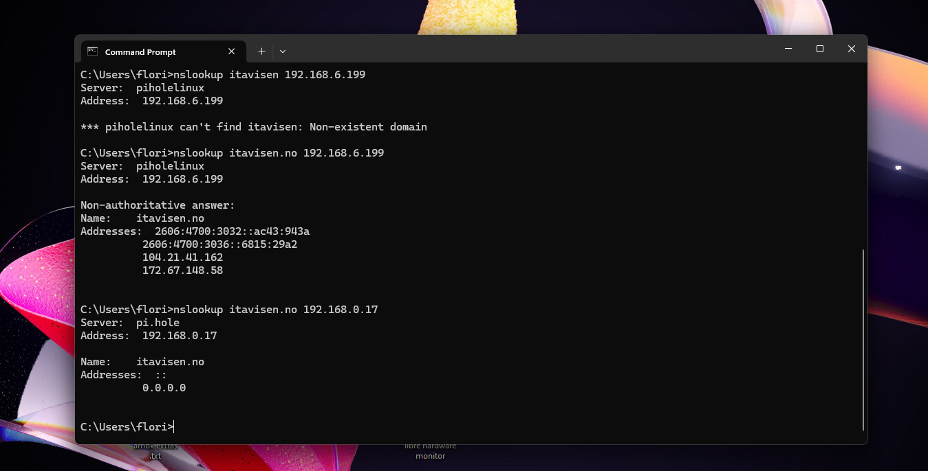

1 works flawless but 2 and 3 dont get even most of the request i sendt to them and by that do not block them. Its like the Linux its catching them and responding to the request instead.
The way i have tested is was in windows with "nslookup [Webaddress] [ip of dns server / pihole]
when i send it to 1 i can see the querries going to the right nettwork and it responding as it should .. but 2 and 3 dont even log and DNSqueries even though i send it to them. Hence they are not blocking ads or websites as they should at all.
here is an example, itavisen.no is blocked on all piholes.
192.168.0.17 is the pihole, 192.168.6.199 is the VM with the latest linux server and pihole installed
it clearly looks like that 192.168.6.199 is responding correctly and the server name is also correct but it cleary gives a respond it should not because itavisen is also blocked there. But pihole query logs are empty because pihole has never recived a request.
i am not a linux user but this makes no sense to me at all
