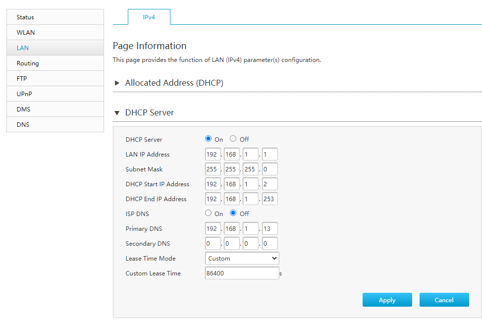

From my understanding the router should only have the pihole as a dns correct?
The first command shows your device is using your router IPv6 address as DNS server, not Pi-hole:
[i] Default IPv6 gateway(s):
     fe80::1
Did you renew the DHCP lease on your devices after changing it in the router?
Are you able to turn IPv6 off in your router?
