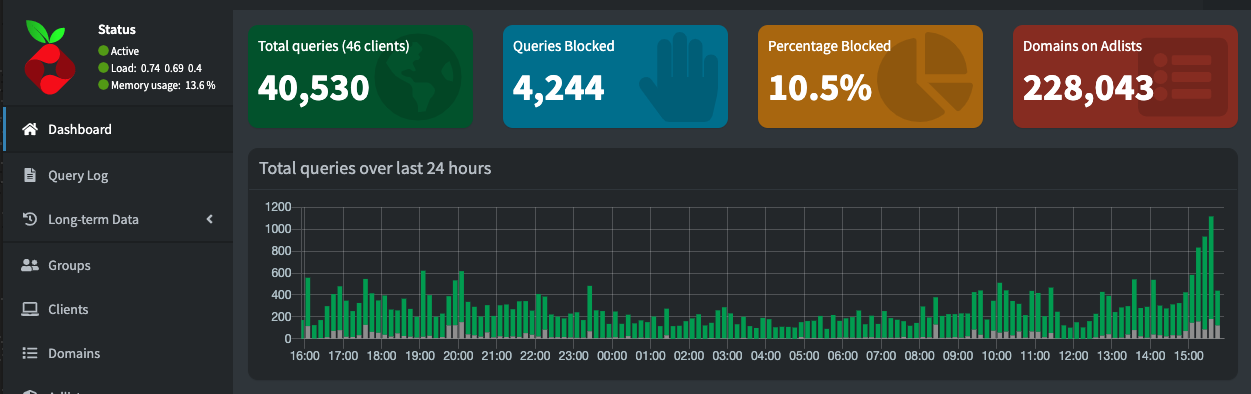

Pi-hole is no longer blocking the bulk of my ads. I can see from the dashboard it's still analyzing queries and blocking some.
However most of the sites I visit where I normally don't see ads I'm now seeing ads. Even on my mobile devices I'm seeing ads in the apps where I previously didn't see any ads.

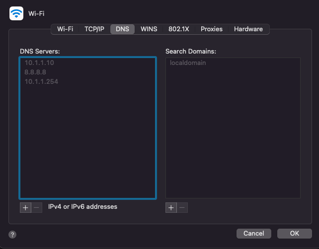

Currently my DNS is setup with my Pi-hole (10.1.1.10) as the primary and I have Google (8.8.8.8) as my secondary on my main network gateway.
search localdomain
nameserver 10.1.1.10
nameserver 8.8.8.8
nameserver 10.1.1.254

Now if I change the network settings on my laptop to static and only look exclusively at Pi-hole (10.1.1.10) for DNS the blocking works as expected. However if I change it back to automatic DNS, it sees my Pi-hole (10.1.1.10) as primary and Google (8.8.8.8) as secondary, but for some reason it's not blocking as expected.
This is happening on all devices on my network. The only change I made was upgrading to Pi-hole v5.12.1 a few days ago, but I'm unclear if that's what's caused the issue. This Pi-hole instance has been running for years without issue, so I'm confused what changed to affect all my devices.

If you have Google 8.8.8.8 as a secondary on your main network, that seems like the reason that you're not seeing the expected blocking. Some of the lookups will be going through your Pi-hole on 10.1.1.10 and those will have ad blocking. The rest will be going through Google 8.8.8.8 and those are never seen by Pi-hole and will not have ad blocking.
If your router's DNS is that 10.1.1.254 entry, then some of the lookups are probably going through that too, and similarly they will not be seen by Pi-hole and will not have ad blocking.
Log in to your router and find the DHCP section and make sure it's only giving out the Pi-hole's DNS address, not Google's too. Then disconnect and reconnect your Mac from your network and have another look at your nameservers using whatever you did above.
You can also see it in the MacOS's graphical interface --> Apple icon / System Preferences... / Network / select the network interface that's green and says "Connected". On that screen you can see your Mac's IP address, router and DNS. Use --> Advanced / DNS to look in detail at the DNS servers available if needed.

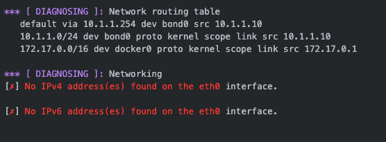

I was looking at the Pi-hole debug logs myself and this stands out
I'm not exactly sure what that means (currently Googling) but that can't be good and is likely part of the problem, if you have any further thoughts.

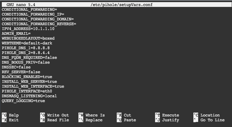

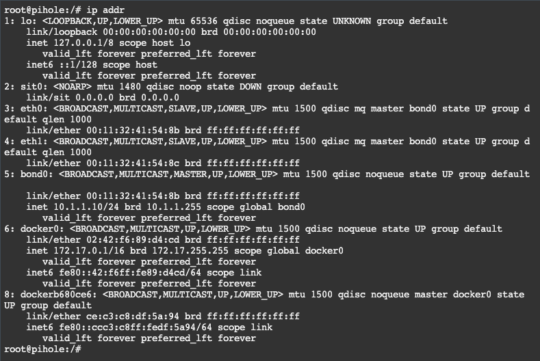

I may have found what the problem could be, looking at the address table on my Pi-hole
Then looking at my config
I think that I may need to change my config PIHOLE_INTERFACE to look at bond0 or docker0 instead of eth0, but I'm just inferring at this point. I'm unsure what change I should make.
You have two interfaces, eth0 (SLAVE) & eth1 (SLAVE), that are bonded resulting in a bond0 (MASTER) interface with an IP configured.
Plus a docker0 interface with IP implying that you're running Docker on the host.
Do you run Pi-hole in a Docker container or are you running it directly/bare metal on the host?
I’m running it in a Docker container on my Synology NAS. So does that mean I need to change the interface in my config file?
Well that docker0 IP 172.17.0.1 is outside your LAN's subnet which I suspect to be 10.1.1.0/24.
That would mean your clients wont be able to address/reach that IP for DNS.

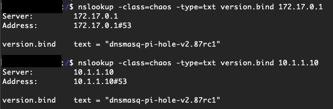

I booted up a shell on my own Synology and it seems nslookup is available.
So you could also try do below one on the Syno to check at least if something is answering on that docker0 IP:
nslookup -class=chaos -type=txt version.bind 172.17.0.1
Or on that bond0 interface:
nslookup -class=chaos -type=txt version.bind 10.1.1.10
Answer should be similar like below:
dehakkelaar@nas:~$ nslookup -class=chaos -type=txt version.bind 10.0.0.4
Server:         10.0.0.4
Address:        10.0.0.4#53
version.bind    text = "dnsmasq-pi-hole-2.87test8"
Looks like it is responding... but unclear how this helps.

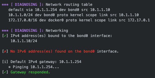

I took a punt and changed my config to bond0, no surprise IPv4 is passing but IPv6 is failing.
You dont need IPv6 for your clients to resolve DNS.

However what are you suggesting at this point, to disable IPv6? Even with the settings changed to bond0 I'm still seeing the same behavior from my original post.
Below bit?
That is probably due to:
EDIT:
Leave it as it is if its working.
That debug message is only a sort of warning.

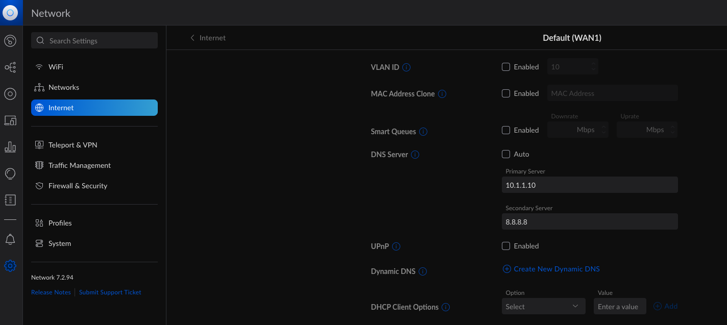

EDIT: Ow from that screenshot you posted in the OP it seems your configuring it in the WAN section.
What DNS server is configured now in that field?
Is it solely the Pi-hole IP or is there another like in the OP?
EDIT2: Ow sorry, it wasnt in the OP.
I mean this one:

I wasn't aware you were running in Docker or using a bonded interface when I wrote that reply. Your initial post seemed like a common case where someone has a simple home network and the router turns out to be handling some queries, or using ipv6 to handle some queries, leading to some clients effectively bypassing the Pi-hole.
Regardless of the cause, if you're on the Mac and have multiple DNS servers configured in the OS, which you do, macOS's mDNSResponder service will send queries to all of them and go with the server which responds first. I suspect that means that Pi-hole and your router see most of it, and Google less so since it's external to your network. But even so, any queries hitting your router won't have blocking.
It may be that a recent OS or app update somewhere in the mix has subtly altered the timings, making your router a slightly quicker responder, leading you to see a big drop in Pi-hole blocking.
So I think actually just changing the IPv4 settings from eth0 to bond0 has done the trick. I had tunnel vision last night and was just testing with my MacBook and iPhone, however today when I checked a Windows machine and my iPad the blocking was working properly. I must just have cached settings on my iPhone and MacBook from all the tinkering.

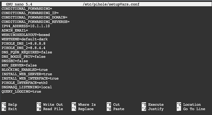

However I do have one final problem I'm editing /etc/piphole/setupVars.conf to change the settings, but every time the container is restarted it reverts back to eth0. How do I get the config to keep the change to bond0?
I'm not that well versed in Docker but as Pi-hole is running in a container, I suspect that bond0 interface doesnt exist inside the container.
I suspect the container has its own interface inside the container which is most likely eth0.
