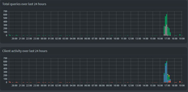

En regardants le graph, j'ai ceci :
pihole-01
caractère en anglais
On peux voir que celui-ci fonctionne quelques temps, puis deviens totalement inactif :frowning:

The graph shows that your Pi-hole has been operation all the time (as indicated by the activity at each hour). The problem appears to be that your clients have found another DNS server to use during these periods.
Pi-hole will not block YouTube ads - these are served from the same domains as the content.

But, i changed the parameter in my box. How i can transfert all DNS via pi-hole ?
If i check on my compteur, i have :
pihole-02
(ip is good)
(it's not just for 1 computeur, but also for my laptop, smart Tv, phones, ... ; all seem lost the Pi-hole DNS).
Maybe if i use the DHCP option, I would not have this issue anymore ?

since this morning everything has been working without any interruption.
I'll come and share the logs with you if it starts again. :slight_smile:
