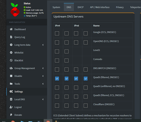

Sorry for the confusion on the upstream variants, by upstream I meant these checkboxes ( make sure the IPv6 ones are ticked )

I set the IPV6 OpenDNS Family Shield addresses already there in the custom 3 and 4 fields. My main router from the ISP unfortunately doesn't allow me to configure IPV6 settings and I can't change it because the cable is fiber optic directly but I think I can find a workaround by connecting another router that has IPV6 control with LAN to WAN connection with a different subnet and have all of the devices connect to that network and I can just set there the Default IPV6 DNS just like you said. Thanks a lot!
