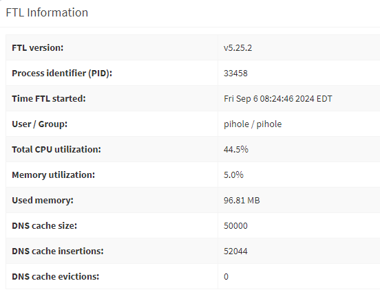

I saw that FTL v3 supported more than 1M queries in a 24 hour period. - I'm trying to make use of pi-hole on a large scale - roughly 2K clients. I'm getting easily 1/2M requests in 10 mins.
I'm running into a problem where CPU usage goes high and in bound DNS requests start to timeout. Restarting resolver brings things back to normal for some time, then gets worse again.
At first, I was getting a lot of evictions with a the cache set to 10000 - so I've been bumping up the cache so I don't get any evictions but still having a CPU issue.
I'm running on a ESXi VM, 4CPU, 2GB RAM
Anyway I can get pihole working on a larger scale?

Thanks so much for the feedback - I have some additional info that may help. Since the original post. If/when queries started to timeout, as soon as we were to issue a reload, things were immediately better.
I did come across this article (Five nines with Dnsmasq) and have added the dnsmasq options "all-servers", "no-negcache" and "dns-forward-max=5096" to the config.
I reverted the cache size back to 10000 and set pihole MAXDBDAYS to 0.
I've disabled all adlists and just have a handful of regex allows/blocks.
I've disabled query logging.
I can easily throw more resources at pihole. Will enable debuging and I should have more info in just over 24 hours. - Enabling debugging just now, running for 5 minutes with 7K queries, is causing a high CPU load...I'm not sure if I'll be able to let this persist to collect any info. - Is there a slightly lighter debug level available?

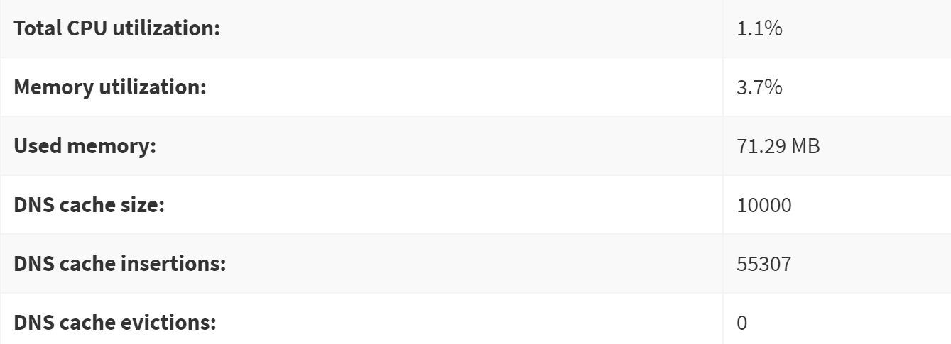

With little load (~1M queries in 9 hours) pihole stats show (with changes above, excluding debgug)...

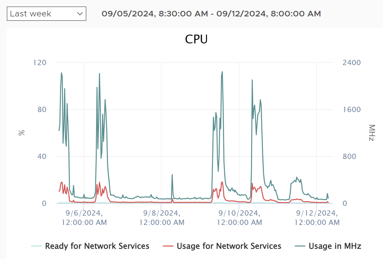

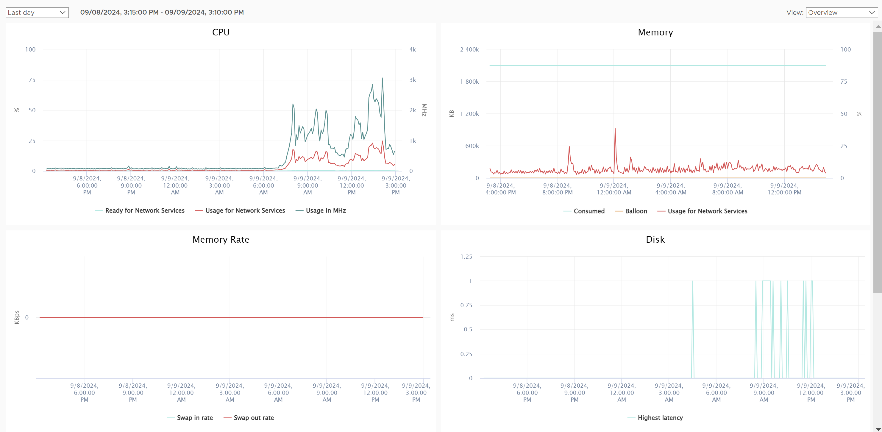

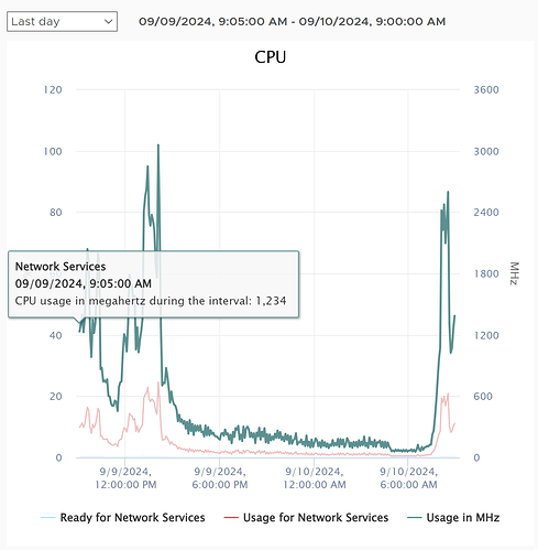

Below is what the VM resourse utilization shows. Disk latency seems only spike in the off-hours but still stays near zero.

To me, honestly, this currently very much looks like a slow disk not able to keep up with data being written to disk. How do the VM metrics look like with debugging turned on?

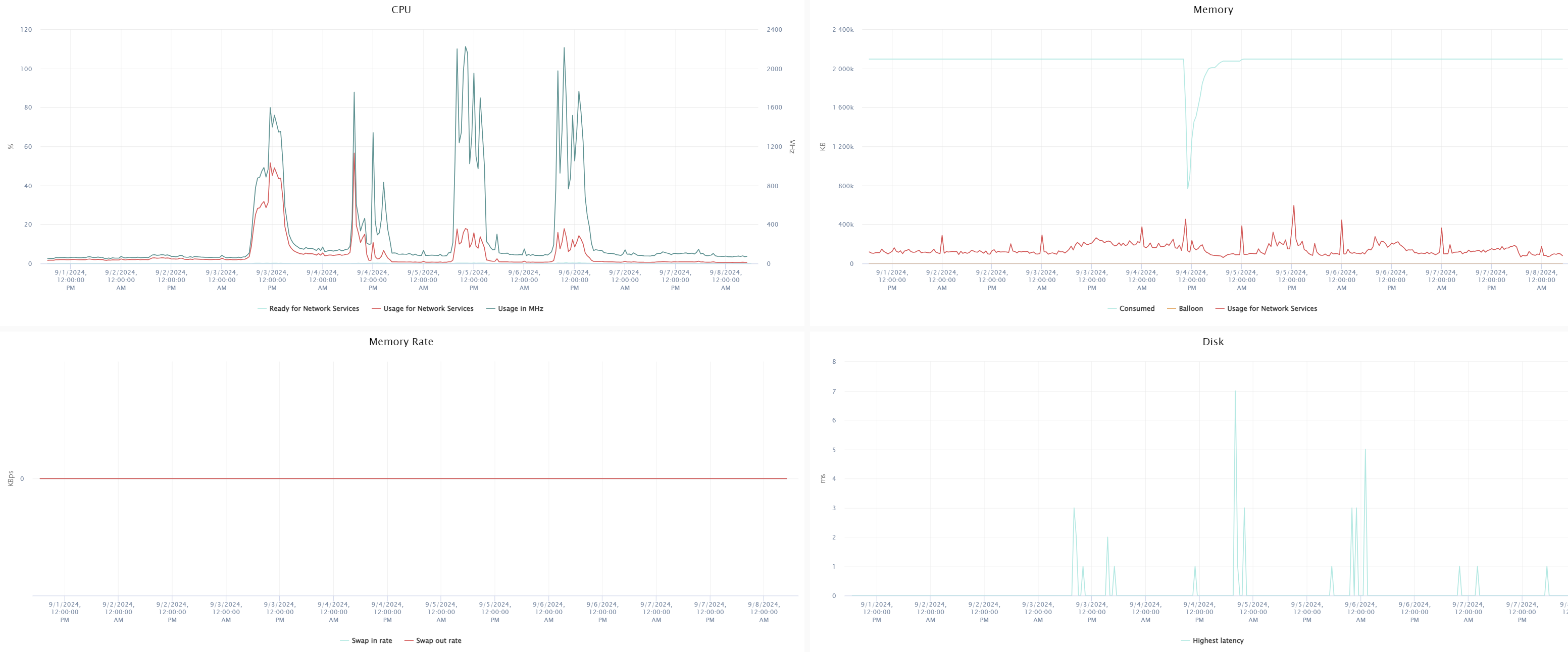

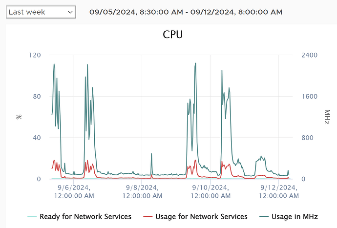

Here are VM metrics....it's really just seems to be the CPU that goes high and drops after a restart. First screenshot includes timeframe of enabling full debugging. Second screenshot is today, after a restart.
