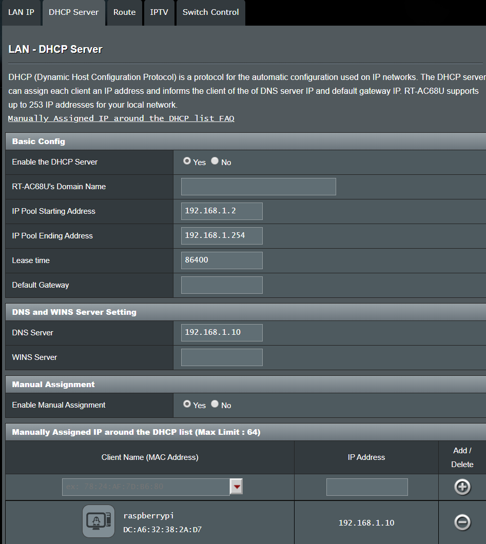

Your clients are not configured to use your Pi-hole (correctly). How did you configure your router?
I configed the router to have rasphbeery has a static address 192168.1.10, then config the dns address as 192.168.1.10.

Can you show us a screenshot of the page in your router where you put in the settings? Maybe it didn't accept it or doesn't use it. Is there also a DHCP page somewhere? Can you enter the Pi-hole's IP address here as DNS server as well?

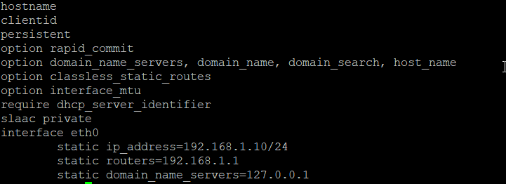

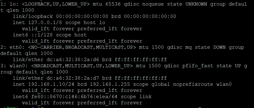

What are the outputs of the following commands from the Pi terminal:
ip addr
sudo grep -v '#\|^$' /etc/dhcpcd.conf
Your IP is on the wireless interface, and you have Pi-Hole configured on the ethernet interface. You also have reserved the .10 IP for the ethernet interface, not the wlan interface.

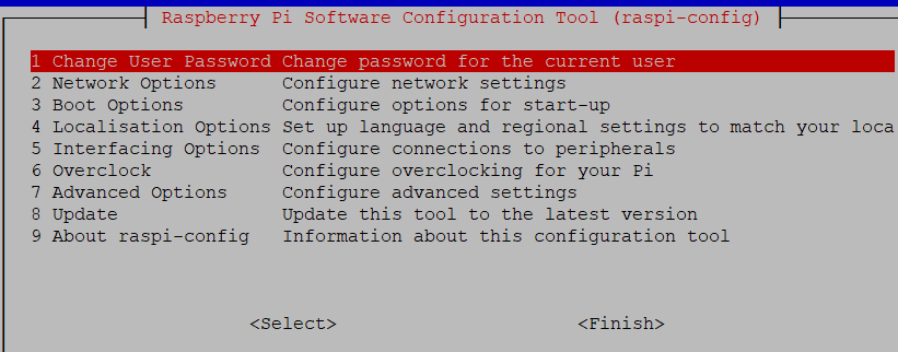

No, on the Pi. Run sudo raspi-config and select the interface there.
could not find the proper item to choose to setup the interface.
which one should I choose?
2 Network options
Which of the interfaces do you intend to use, the ethernet or the WiFi?
