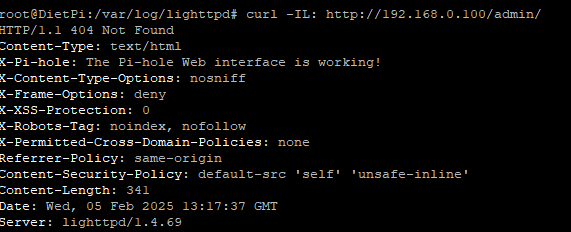

Via web browser on the http://192.168.0.100/admin/
I'm actually getting a 404 error
I've tried pihole -r and that didn't fix it. It seems like lighttpd is purposely denying the traffic as if it were external/public traffic, but I can't find how to change this.

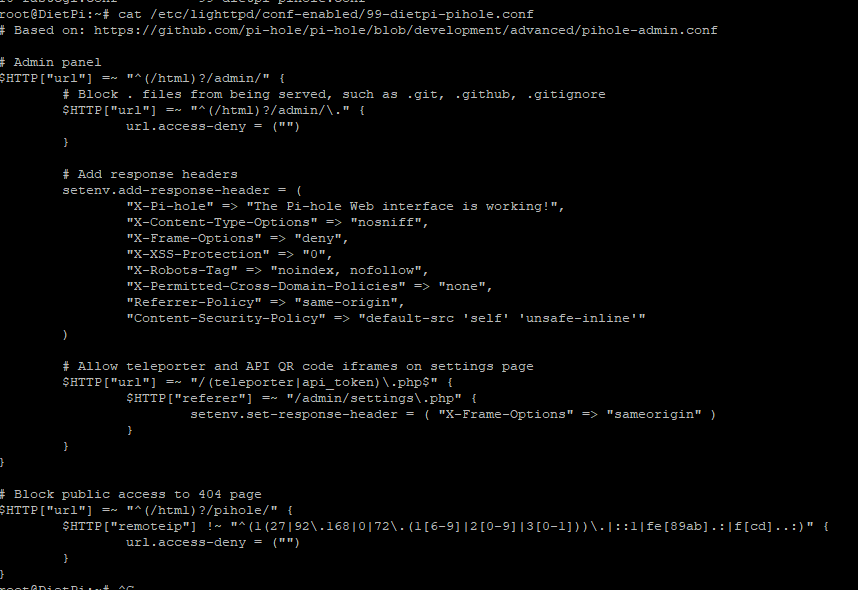

This bottom part of the config does so for the deprecated block/404 page only, i.e. when you access the /pihole or /html/pihole path. It is however not used anymore anyway, unless you configure Pi-hole actively to do so.
Access to /admin should be allowed. There is a dialogue asking whether you want to block public access to the admin panel as well, and this can block local access if you access via IPv6 and do not use ULAs in your network, but you are accessing via IPv4 address explicitly.

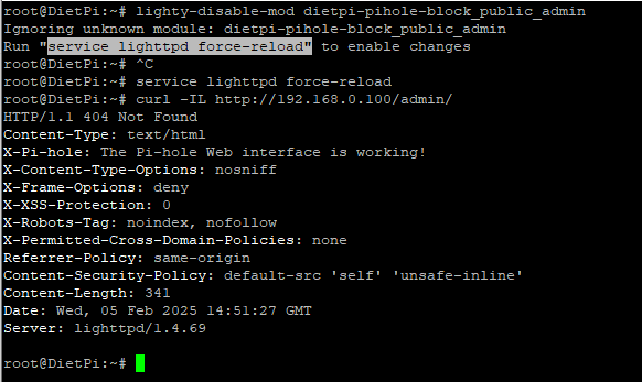

Ah my fault, this one:
lighty-disable-mod dietpi-pihole-block_public_admin
systemctl restart lighttpd
Unfortunately this is still a no go:

Okay, then this block config was not enabled in the first place. Although, weird is that it is not present at all in your case. I just did a test install:
root@VM-Bookworm:~# lighty-disable-mod dietpi-pihole-block_public_admin
Already disabled dietpi-pihole-block_public_admin

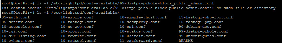

Can you see whether the file exists?
ls -l /etc/lighttpd/conf-available/99-dietpi-pihole-block_public_admin.conf
It is created in any case during the installation, just not enabled by default.
Did your installation fail and abort at some point? It could have been the download of exactly this config. That would explain the 404 as well, as the needed symlinks are created afterwards. E.g. try this:
curl -IL http://192.168.0.100/html/admin/
http://192.168.0.100/html/admin/ works!!
