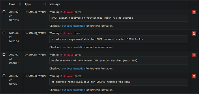

Pi-hole is showing me warning in dnsmasq core too often, could anyone explain what this is all about and how to fix it?
The issue I am facing:
Warning in dnsmasq core

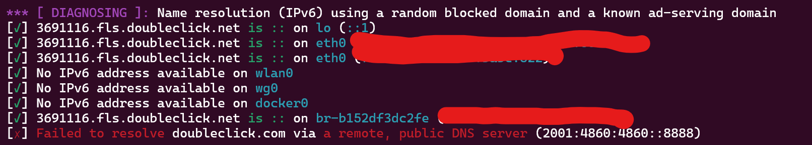

The links to the docs are in the messages. Can you create a debug log and post the token URL and someone can check your setup. Run the command below to create the log and auto upload it to the secure server.
pihole -d -a

The linked documentation will fully describe each warning.

Ok here is my token URL: https://tricorder.pi-hole.net/jLmOjsgz/

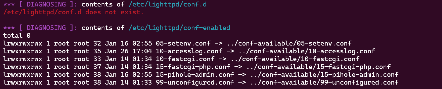

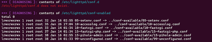

By the way, I got these errors when I run the command:
*** [ DIAGNOSING ]: contents of /etc/lighttpd/conf.d
/etc/lighttpd/conf.d does not exist.
This is expected and it's not an error.
You are using Debian. This directory only exists on RedHat/CentOS/Fedora distributions.
Yes that's correct thanks

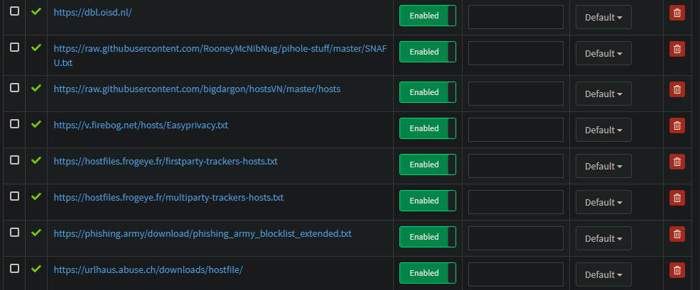

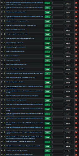

Also, could you please tell me how many default adlist pi-hole has because right now I only got these in my Pi-hole that has a green trick
However, the rest of these has a green circle and I don't know what it means.

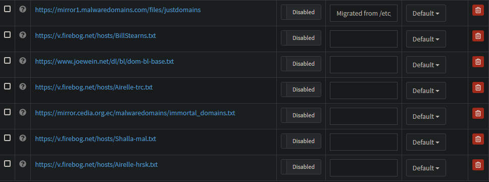

And these have red marks, I don't know why so I have disabled them
I would much appreciate it if you could help me with these to understand it, please.
You can click the icons to see more
Green circle
"List unchanged upstream, Pi-hole used a local copy"
> it hasn't changed since Pi-hole last downloaded it
Green tick
"List download was successful"
> it has changed since the last download so Pi-hole has downloaded the newer one
Grey circle
"List was not downloaded so far"
> you have just added the list but not done a Gravity update yet
Orange icon
> means an error of some sort, usually that the list is not available. These also cause a warning in Tools > Pi-hole diagnosis: "Adlist with ID xx was inaccessible during last gravity run."
Red cross
"List unavailable, there is no local copy of this list available on your Pi-hole"
> list went away before you ever grabbed a copy, or maybe you've made a typo so check

Thank you for this wonderful help, guys I manage to fix it. it turns out that my ISP does not support IPV6, which is why I got these errors as my IPV6 is enabled.
