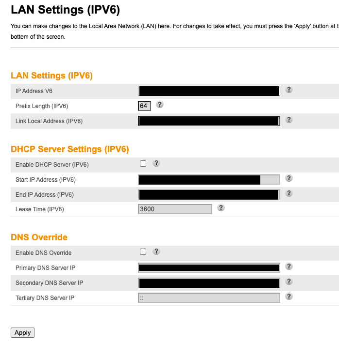

Here is a screenshot of my router's IPv6 settings.
What I think should be done:
  1. Enable DNS Override
  2. Set the Primary DNS server IP to the pi-hole 2601:xxx address
  3. Set the Secondary DNS server IP to :: (aka nothing)
Thoughts?
What are the security implications?
Is it wise for the pi-hole global-link 2601: IPv6 address to be set as the Primary DNS IP?
Thanks,
P1NECO

I overrode the IPv6 DNS and placed :: in the primary, secondary, and tertiary server IP address boxes. This did NOT work. My router still distributed the default ISP address to all clients, and IPv6 traffic circumvented the pi-hole.
I ended up placing the 2601 global-link IPv6 address of the pi-hole as the "Primary DNS Server IP" and left the secondary and tertiary IP addresses as ::.
This worked!
I was able to power cycle my Pi and confirm that it was not given a new global-link address. BUT we will see what happens when the ISP decides to distribute a new IPv6 address... that remains to be seen.
This is temporarily solved. All IPv4 and IPv6 traffic is blocked (according to my block lists) on all devices on my network for now. I will watch for changes from my ISP and update this forum if it is not closed when that happens.
