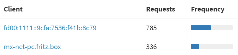

Hello Community,
my new ISP gave my IPv6 Internet and I have some questions regarding Pi-Hole, IPv6 and Hostname display in Pi-Hole logs.
Please see Pi-Hole network info screenshot.
  • Like my router 10.1.1.1 is not getting a hostname at all. And that's the only device where I actually manually defined a hostname to use via the routers config.
  • Some devices do get the IPv4 hostname displayed, but not the IPv6, like the NAS.
  • Yet other devices (not shown in screenshot) actually do get some hostname assigned to both IPv4 and IPv6.
  • This leads to 2 log entries for each device, one for IPv4 which usually also gets a hostname to show for easy client identification. And then there's the IPv6 where only the IP address is shown in the logfiles. This is making it quite hard to identify which device is sending queries, since IPv6 addresses ain't easy to memorize.
  • The router is acting as DHCP Server and Pi-Hole does DNS only.
    The router provides Pi-Hole DNS Server IPv4 and IPv6 to its leases.
    In Pi-Hole I use conditional forwarding to my router IP, so that name resolution for local devices works at all with my setup using separate DHCP server.
    There is only one field for conditional forwarding in Pi-Hole config and I cannot seem to add conditional forwarding for IPv6 to the router's IPv6 address. Which would be the solution if I understood the involved networking principles correctly.

The hostname of your devices is discovered through PTR queries (reverse DNS). Your local network is 10.1.1.0/x I assume, then such a PTR query would look like 5.1.1.10.in-addr.arpa (IP address in reversed order) and the answer would be the hostname of that device, mx-nas.fritz.box. The "issue" with the conditional forwarding on the web interface is that it is very specific about which of those domains it forwards. It actually only forwards those that look like xxx.1.1.10.in-addr.arpa. But the PTR query for that devices link-local IPv6 address would look like 6.8.4.e.3.8.e.f.f.f.2.3.1.1.2.0.0.0.0.0.0.0.0.0.0.0.0.0.0.8.e.f.ip6.arpa, that obviously does not fit the template for the IPv4 addresses and is thus never forwarded to the router where it should go.
You need to create a custom config file like /etc/dnsmasq.d/conditional-forwarding.conf on the device that hosts Pi-hole (the actual name isn't important, just the directory) and add your new templates for PTR queries like this:
server=/0.8.e.f.ip6.arpa/10.1.1.1
The first field is the template for the domain (i.e. every domain that ends with 0.8.e.f.ip6.arpa will be forwarded). The second field is where that query should be forwarded to, i.e. your router at 10.1.1.1.
Now you need to add such a rule for every one of your IPv6 prefixes that you might encounter and you are golden.
Or be lazy and do this:
server=/arpa/10.1.1.1
Just forward the entire arpa domain to your router. This will include every PTR query that comes up in your network, so make sure you are not creating a DNS loop in your network. This means Pi-hole cannot be the upstream DNS server of your router itself. There is this handy guide for the FritzBox: Fritz!Box (EN) - Pi-hole documentation (Avoid/Undo the middle part of that guide: Pi-hole as upstream DNS server for your Fritz!Box).
After you do all that don't forget to restart the DNS server (pihole restartdns or click the button on the web interface).

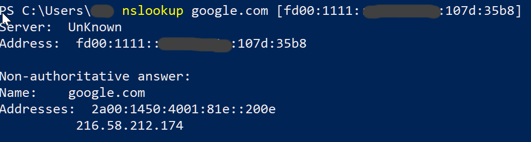

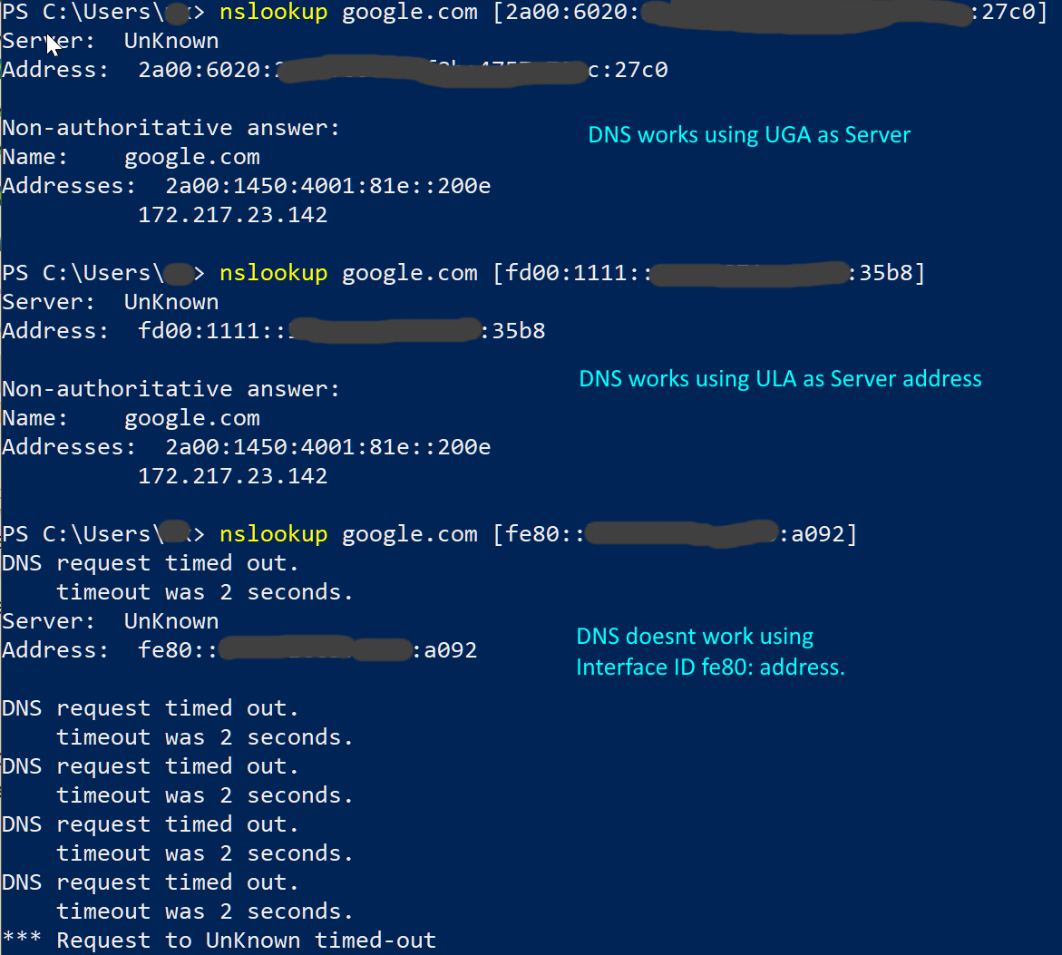

It could be I was already encountering some sort of DNS Loop. Would this explain a large set of NXDOMAIN, NODATA and Retried log entries? Somehow the network and DNS resolution still worked. Need to find time later to implement the new config file.
More info on current config:
  • Pi-Hole IPv4/6 was set as the Upstream DNS in the FritzBox.
  • Pi-Hole IPv4/6 is distributed to the clients as DNS server to use via DHCP, so I can see individual clients statistics.
  • Pi-Hole has conditional forwarding back to FritzBox for IPv4 enabled.
  • Pi-Hole runs a local unbound installation as its sole upstream DNS entry.

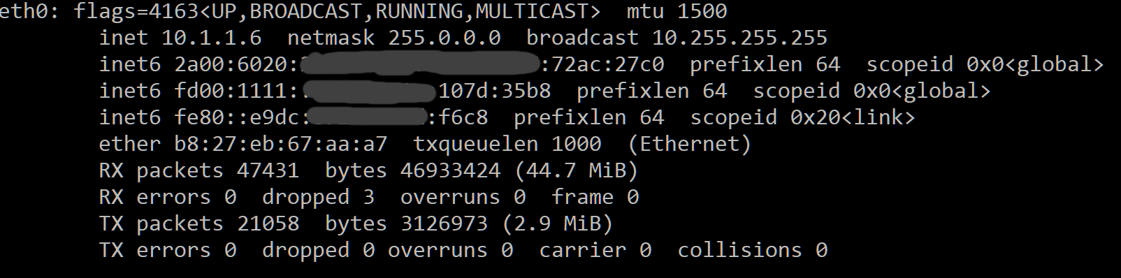

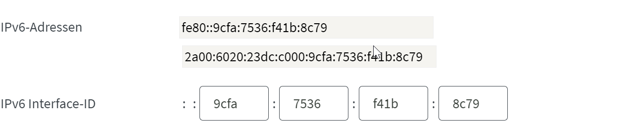

And finally another IPv6 question.

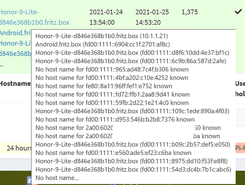

  • Basically (literally) each device on my network now has 3 IPv6 addresses where I kinda understand the purpose. Global IP from router, fd00: for local, and fe80: for link local / loopback or whatever.
  • Except my cellphone. It has a ton of fd00:. Why? :slight_smile:
The conditional forwarding is there to prevent leaking data to the outside world by keeping PTR request for local IP addresses inside your own network. It is limited to the domain you specified (arpa I presume) and wont affect any other traffic.
This is what I tried to explain here:
Pi-hole saves all its queries in a database, and part of every query is the IP address that issued that query. This address is then associated with one of your clients and displayed in the network overview. Even if the device itself is no longer using that IP address, it is still stored in Pi-hole's database and is therefore still displayed in the network overview.
The reason why you see a lot more ULAs (fd00::) than GUAs (2a00::) is probably that the ULAs are preferred when connecting to another ULA inside your own network. The GUAs are used when the device actually connects to the outside server (you can't even use the ULA in this case at all).

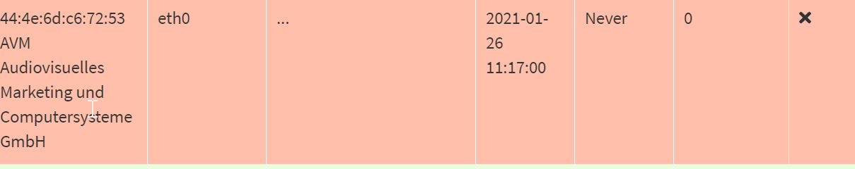

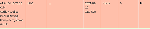

2021-01-26 13_17_04-Pi-hole - rpi-dnshole
  • This IP address is not assigned anywhere in the router. Looking up the MAC address results in "invalid MAC". Scanning the LAN does not show any device 10.1.1.38.
Another two devices with invalid MAC addresses.
  • I wonder where Pi-Hole gets this data for hosts with invalid MAC addresses. No idea how to identify an unknown device when I cannot even figure out the vendor by MAC lookup. There are 40 devices in my home LAN and I kinda want to identify which one is causing this.

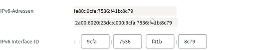

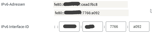

FritzBox router is supposed to Firewall IP4 and IP6 in the same way, e.g. do not let any fishy traffic into my network and shield my local hosts from external access. Do not expose local hosts to the internet.
Now, with IPv6 my Pi-Hole got, in addition to the fe80:/fd00: local addresses, the globally unique address 2a00:6020:[..omitted for security..]:24f8.
This address is supposed to be behind the firewall and not accessible externally. From external LTE network I can access this 2a00:6020:[..omitted for security..]:24f8. firewalled IP in ways that should not be possible:
  • I can ping it. Says host online, but all ping packets are lost. The ping command should stop at the FritzBox firewall as last hop and not tell anything about device status of my local hosts. There is an option in FritzBox to enable PINGv6 for a device which has port forwarding enabled. But I have not done so for Pi-Hole, yet its IPv6 is pingable.
  • I can visual traceroute it. It gives pretty exact geolocation of where my hosts are located. The tracert discovery should stop at router firewall as the last hop, not at the Pi-Hole host hop inside my LAN.
So, is this the way IPv6 works? Each of my internal hosts is now exposed to the internet with its own global IP which any hacker can scan for security flaws?
  • Lets say with IPv4 I kinda understood how the firewall worked. With IPv6 not so. Its exposing the global hostnames, but still shielding the ports of each host form external access. How can I find out if the firewall is actually working as intended?
  • I still don't understand how the Pi-Hole's global IPv6 is directly pingable at all, since I haven't enabled any PINGv6 forwarding to the RasPi in the router.
  • Do I have to firewall all devices separately? I hope not, have a bunch of IoT stuff that has no built in firewall.
  • On the other hand, when I scan for open server ports on Pi-Hole global IPv6 2a00:6020: from external LTE net, they are all shown as closed or blocked. I think this looks OK.
  • When I scan Pi-Hole's 2a00:6020: from within my WLAN, it shows open ports 22, 53 and 80. I think it totally makes sense it works this way, since I access from local. But I really hope those ports are never accessible from external networks (as long as I do not open some ports for VPN etc).
  • tl;dr - Can I safely assume my IPv6-enabled networks still is as secure as it was with the IPv4 only connection?

  • They could be from guest's devices that have left and their devices aren't registered in the Fritz!Box anymore. Pi-hole still knows them because they were stored in the database.
  • Some devices randomize their MAC address when joining a new network, almost similar to Privacy Extensions for IPv6 addresses. Apple's explanation: Privacy features when connecting to wireless networks - Apple Support
  • The MAC address might simply not be registered with a certain vendor. I recognize 62:ff:4d:xx:xx:xx, it's the MAC address of my Fritz!Wlan Repeater, so it probably belongs to AVM even though it's not in the vendor database. (Actually, the label on the device says 7c:ff:4d:xx:xx:xx, which does officially belong to AVM. Might be bug in this case.)

I can successfully do both of those things with my routers public IPv4 address as well.
I used https://gsuite.tools/ for testing.
When I do both for the IPv6 GUA of a device on my LAN:
  • Ping results in Destination unreachable: Administratively prohibited.
  • Traceroute stops at the router, just as you expected.
The internet protocol used for communication should not make any difference in what traffic is filtered by the router's firewall. My Fritz!box's firewall is doing its job keeping this traffic out. Is your Fritz!Box's firewall correctly configured? Did you interpret the output of ping and traceroute correctly? If it is and you did, this would be a security issue and a case for AVM's support.

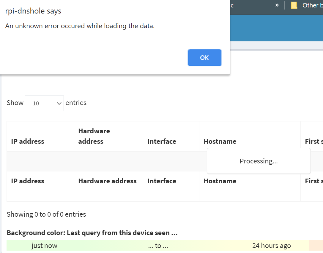

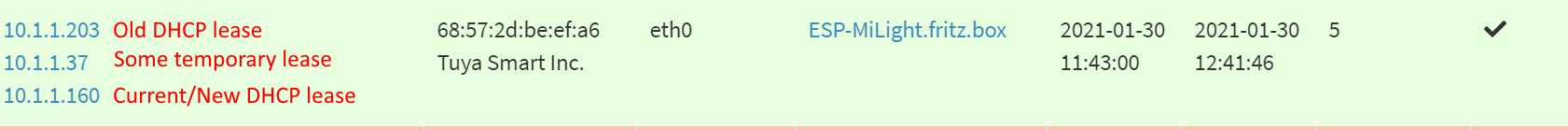

Hello again, I further worked on my network and ran into other issues and inconveniences, obviously.
  • I was about to complain about of seeing a ton of Unknown log entries, but there was a Pi-Hole patch today which mentioned a fixed bug which might have caused this.
  • The issue is this:
    Client sends requests via both IPv and IPv6 hostnames.
    All requests originating from IPv6 hostname are resolved correctly.
    All requests originating from IPv4 hostnames seem duplicated of the IPv6 hostname requests.
    Nearly all (90%) those IPv4 requests create a Unknown response in Pi-Hole.
I hope this is the issue fixed in Pi-Hole 5.6 / latest version.
Regarding the duplicate / stale network table entries: Rebooting router and Pi-Hole kicked out any old DHCP leases, this looks quite fine now.

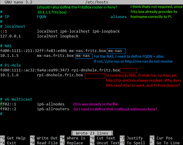

  • My Synology NAS was rather stubborn not providing the IPv6 hostname to Pi-Hole.
  • Since it has a static IPv6 local address, I have added the IPv6 it to /etc/hosts on Pi-Hole.
    Is this a valid solution to provide a hostname?
  • Here is an annotated screenshot of what my hosts file now looks like, with some questions penciled in.
Does this /etc/hosts file look good to you? Is there anything thing else that should be in here? Or not be in here?
Thanks again!
Yes. Alternatively, you could use the GUI option under Local DNS > DNS Records. Under the hood, that will just save it to /etc/pihole/custom.list, which has the same format as /etc/hosts and serves the exact same purpose. But using /etc/hosts directly is perfectly fine too.
should I also define the FritzBox router in here?
If you are also conditionally forwarding the local domain, i.e. you also added server=/fritz.box/10.1.1.1 to your custom config file, it isn't necessary. Pi-hole doesn't use the hostnames it got via PTR records to resolve queries for those hostnames. It will still forward those queries upstream, so you probably want anything that ends with fritz.box to be forwarded to the FRITZ!Box as well.
For the NAS, I need to define FQDN + alias. If not, \\mx-nas or http://mx-nas do not resolve
I can't replicate that (I tried). My first idea was that maybe your (file-)browser doesn't automatically add .fritz.box, but you say that it works fine for http://rpi-dnshole/. My next idea is that maybe the Fritz!Box's DNS Rebind Protection could play a role. Although, on second thought, by explicitly creating a DNS entry for the NAS you avoid asking the router entirely and it's rebind protection shouldn't matter.
I don't know why one need an alias but not the other.
Does http://mx-nas.fritz.box/ resolve at least? Or does the NAS not respond at all without the alias?
Do I need to define IPv6 multicast addresses here?
If you have any additional multicast groups, yes. If not, well, you have nothing that needs to be defined.
Aside from the spelling error this looks fine to me.

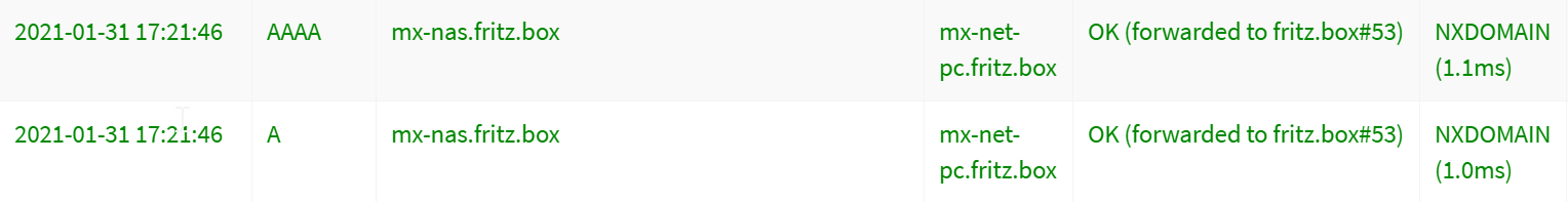

Hello again.
I have added the conditional forwarding for the fritz.box domain to the custom config.
Today I see that IPv6 hostnames back to not being resolved again. The only other "change" that occured yesterday was a reboot of the FritzBox. I am not sure if this is at all related to the conditional forwarding, or a FritzBox DHCPv6 issue, but here's what I found out.
As said, mx-net-pc IP6v not resolving today. Yesterday, both has the hostname displayed.
Then I had a look in the FritzBox and what do I see:
The mx-net-pc client simply missing the fd00:1111 ULA address.
I mean, FritzBox assigned that ULA to the client, and the client is communicating via that ULA in the LAN, so it should be known to the device actually assigning the IPs via DHCP leases. Anyways, I made a ticket at AVM to be sure, maybe there's some fiddling with my routers IPv6 settings required.
My conclusion: If fritzBox doesn't know that [fd00:1111::9cfa:7536:f41b:8c79] is the IPv6 of mx-net-pc, how would Pi-Hole know.
I noticed that happening earlier, sometimes name resolution worked sometimes not. I think I might have identified the cause of the issue now, but not yet what would the FritzBox forget its ULA assignments. Maybe some network misconfiguration the cause?

  • I have some Tuya Wifi Lightbulb.
  • In FritzBox DHCP "always assign the same IPv4 to this device" is on.
  • It had 10.1.1.203 assigned via the above option, which I needed to change.
  • Somehow flushing DHCP lease got it 10.1.1.37 assigned.
  • The new "static/preferred" DHCP IP 10.1.1.160 only got correctly assigned after rebooting the actual lightbulb, not the DHCP server.
  • So all this was yesterday and in between the FritzBox and Pi-Hole dnsmasq were restarted. The FTL database was flushed to give me a fresh start dashboard.
  • Today I look in Pi-Hole network table, and Pi-Hole thinks all 3 above mentioned IPs are all assigned the the same host. Makes sense so far, since yesterday the host was available under each of them for a few minutes, while I was changing the settings.
Soo, I wonder:
  • How does Pi-Hole still think to know about the flushed leases 10.1.1.203 and 10.1.1.37 IPs? Like Pi's database and net table flushed, DHCP server was rebooted, so all old leases should have been flushed out of the network.
  • Those IPs are currently not assigned at all, so where is that data displayed in network table coming from?
Was it really the Fritz!box which assigned the ULA or did you set a static IP address on the machine? I don't use DHCPv6 to assign IPs, so I don't know how that works with a Fritz!Box; but for SLAAC, mine has a setting that, by default, makes it only advertise a ULA prefix if there is no IPv6 internet connection (i.e. there is no GUA for the device). I assume that will also affect which addresses are assigned via DHCPv6.
Fritz!box 7560: Netzwerk > Netzwerkeinstellungen > IPv6-Adressen
But AVM will know more about that than me.
The leases, yes. The clients IP addresses, no. There is no widely implemented signal that could tell a client to renew its lease. You can reboot the DHCP server all you want, the clients got an IP address earlier and will only get a new one when they ask for one. The easiest way to get a new IP to a client is to reboot the client as you found out.
They are coming from the arp-table of Pi-hole's host machine. In addition to the existing query database, Pi-hole will look through the arp-table to make connections between IP and MAC addresses. With ip neigh you can view all currently known IP-MAC-associations. You need to flush that cache as well, but by doing so, you lose all those IP-MAC-associations and the network overview will be populated with a bunch of lone IP addresses from the query database until those IPs are used again and can be grouped by corresponding MAC address. Which sucks if your clients use Privacy Extensions and you are left with IPv6 addresses that will never be used again.
Flushing the network table is kind of useless as it is, you really need to start from zero to get clean network overview again.
Here is a "one-liner" to do that:
(stop Pi-hole, back up database, flush arp-table, start Pi-hole again)
sudo service pihole-FTL stop \
&& sudo mv "/etc/pihole/pihole-FTL.db" "/etc/pihole/pihole-FTL.db.bak.$(date '+%F')" \
&& sudo ip neigh flush all \
&& sudo service pihole-FTL start
Of course replace the path to the database if necessary.

Pi-Hole install transferred from Pi 2 to Pi 3, IPv6 wasn't static somehow.
I had to move my Pi-Hole installation from Raspberry Pi 2 to a Pi 3 due to technical issues with the Pi 2. The SD card image transfer worked flawless, except one thing:
  • When my ISP became IPv6 enabled 2 weeks ago, I re-ran setup for static IP's via pihole -r.
  • I have booted up the new Pi 3 with a dd image of Pi-Hole, and it got a different ULA assigned. Somehow only IPv4 configured with pihole -r was saved properly as static.
    I guess it makes sense, since its a unique address, and a different Pi gets a different unique address. Which then is the static address of exactly that one device.
  • Is it possible to set an easy to remember static IPv6 via config files? Like would something like fd00:1111::1 be possible in my case? (Am I typing this right? Would the long form be fd00:1111:0000:0000:0000:0000:0000:0001)
  • On the FritzBox, I have provided the Pi 3 new IPv6 within FritzBox so DHCP clients update their DNS server address to use. This seems to work already using the new IP. Should it say server: UnKnown here? With the capital K in the middle of the word, that maybe unbound telling its name in a nerdy way?
  • On the Pi 3, I have updated the new IPv6 in /etc/pihole/setupVars.conf
    Is there any place else in the config files where the changed IPv6 has to be updated? I'm not sure but it seems the IPv6 defined here is not actually used as the IP to be set for eth0 during boot.
  • Some issue I noticed. Network table was broken after booting the transferred SD card image on the Pi 3: unknown error occurred while loading the data. This is just FYI, running your reset db and arp one-liner fixed it and network table works. Might be a bug or something.
I think my DHCPv6 is messed up...
That's a really good question. At least I did not type any manual IPv6 addresses into some clients config files, so no, don't think I use anything static (only exception being the NAS as described in previous posts)
Maybe I have to not use the ULA, but the other address starting with the ISP's router prefix 2a00:6020, even for local networking. The 2a00: address is always known by FritzBox for each client, in contrary to the previously described experience with fd00 ULA not always showing up in the client details.
Anyways, there's a lot of wonky leftover from some IPv6 local networking experiments from the time before my ISP has been native IPv6 enabled. And I think my DHCPv6 settings might be completely off and might explain the "weird" behavior.
I really think those must be set to provide DNS, IA_PD and IA_NA, so the DHCP does actual IPv6 assignment and not only provide DNS server to clients. It would make sense from my point of view, since now with native v6 ISP, I actually got those prefixes for the Fritzbox to provide to clients.
Well, that was also only FYI, going to discuss the FritzBox basic settings with ISP and AVM, but directly leads me to another general IPv6 question.
The above DHCPv6 settings tell me, FritzBox DHCP currently is not assigning actual IPv6 addresses to the clients, but only the DNS server.
  • Then what exactly assigned fd00:1111: ULA?
  • DHCPv6 is only providing the DNS. Is FritzBox maybe assigning those ULAs in a different way?
  • Is FritzBox maybe not telling/assigning a client which ULA to use, but rather asks the client "hey here is my prefix fd00:111, please tell me your ULA within that prefix"?
  • And mostly, how comes Pi-Hole still got a 2a00:6020 address from the ISP prefix space? There must be some other way this global address is defined and assigned, since it can't come from DHCP with my "provide only DNS" config.
Edit: And of course just now (Pi-Hole uptime ~3hrs), the FritzBox automagically knows all the fd00:1111 ULA again and the Pi-Hole IPv6 name resolution is back working. This wasn't the case when I started typing this post, then all the v6 hostnames were still unresolved in stats. This random behavior is driving me nuts :smiley:
Don't shift SD cards or images around between different CPU types!
Doing so is asking for trouble, as binaries may be compiled for a specific CPU's instruction set. You may encounter slow performance, inexplicable failures or outright crashes.
I'd advise against setting static IPv6 addresses on device, unless you are sufficiently familiar with IPv6 and fully aware of the associated consequences.
For your Pi-hole machine, try instead to set a fixed IPv6 interface identifier for that device in your Fritzbox.
Be aware that such an interface identifier only ever gets assigned for those clients requesting it via Stateful DHCPv6. Most clients won't by default, and some never will (e.g. Androids).
This is also relevant for your question:
The majority of IPv6 clients constructs their IPv6 addresses autonomously by combining an IPv6 prefix (procured through Stateless DHCPv6 or RAs) with an interface identifier computed by the device itself using SLAAC.
In that same sense, ULAs don't get assigned.
A client will use IPv6 prefixes as available in your network (i.e. public and ULA prefixes).
It will then combine each such a prefix with any interface identifier it sees fit.
This may or may not include a fixed interface identifier defined in your router.
Even if it does, you could expect your client to have more than one IPv6 address for each prefix (apart from link-local).

Ok, I will do so, since I only got a very basic understanding of IPv6 and your answer concluder there might be security implications involved even when setting a static local IPv6. I will refrain from that step for now.
Pi-Hole seems to have requested the identifier.
  • I wonder how to use it as a server address in my network? It has only the fe80: address assigned and I assume that's the fixed interface ID for this device.
  • However, as I understand, fe80: is the link local / loopback address in IPv6.
  • I would totally use that interface ID, but Pi-Hole/DNS doesn't seem to work on the fe80: addresses:
  • Any tutorials out there for Pi-Hole and Local Interface ID communication?
  • Just need a coarse direction pointer of what I gotta do next in order to use the Interface ID as the static Pi-Hole server address.
Thanks for explaining this. Guess I need to read some topics on SLAAC.

Further, I might have found out why my NAS hostname mx-nas doesn't resolve properly at the moment and I get the name not resolved browser error when trying to access its web interface.
What the NAS is doing:
What other devices are doing:
2021-01-31 17_34_18-Pi-hole - rpi-dnshole
NAS hostname gets NXDOMAIN response. Other devices get IP response as intended. Where to most likely look for the cause - Pi-Hole, NAS or Router?

Warning: Found unknown status 14 in long term database!
Maybe you could have a quick look at the debug token as well: https://tricorder.pi-hole.net/wcshl2f36c
Also it was a good idea to do pihole -r again, the new Pi 3 IPv6 wasn't updated in /pihole/local.list by editing setupVars.
This has been reported and a fix is in the pipeline
