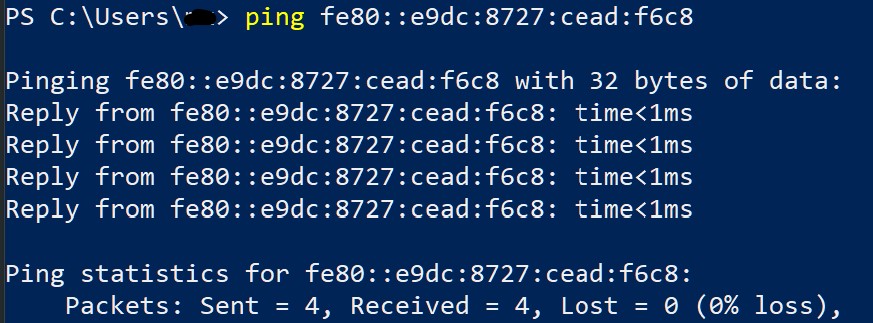

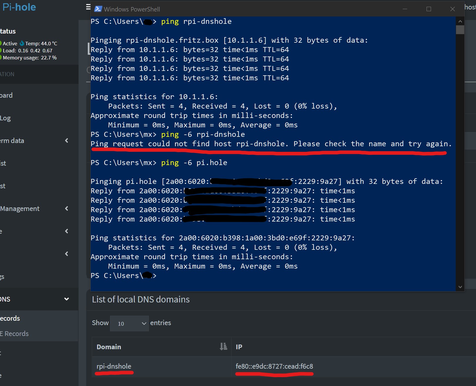

So I tried some more pinging my Pi-Hole server with rpi-dnshole hostname. For whatever reason it is no longer pingable under its IPv6 address.
Just to be safe I added the IPv6 to the local DNS settings. See results. ping rpi-dnshole works. ping -6 rpi-dnshole doesn't.
Just to be safe I checked the IP6 of rpi-dnshole. This works.
  • Where's my error that ping -6 rpi-dnshole doesn't respond with the servers IP6 fe80::e9dc:8727:cead:f6c8

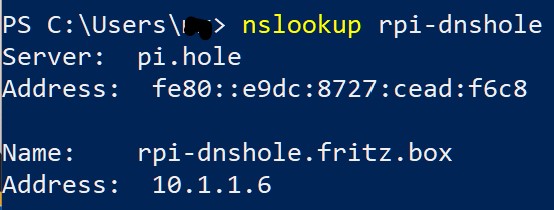

Ping is not a reliable way to test domain resolution. A better option is to use either nslookup or dig.
From the PC, what is the output of the following from the command prompt?
nslookup rpi-dnshole
Then, in the dnsmasq log at /var/log/pihole.log, what query, reply and forward for this domain are shown?
Only retruns the IP4, not the IP6.
Please provide this information.

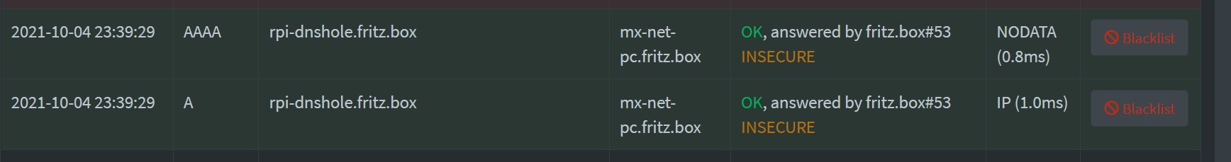

Oct  4 21:55:46 dnsmasq[31467]: query[A] rpi-dnshole.fritz.box from fe80::a41f:aed6:1ea7:bbe3
Oct  4 21:55:46 dnsmasq[31467]: forwarded rpi-dnshole.fritz.box to 10.1.1.1
Oct  4 21:55:46 dnsmasq[31467]: reply rpi-dnshole.fritz.box is 10.1.1.6
Oct  4 21:55:46 dnsmasq[31467]: query[AAAA] rpi-dnshole.fritz.box from fe80::a41f:aed6:1ea7:bbe3
Oct  4 21:55:46 dnsmasq[31467]: reply rpi-dnshole.fritz.box is NODATA-IPv6

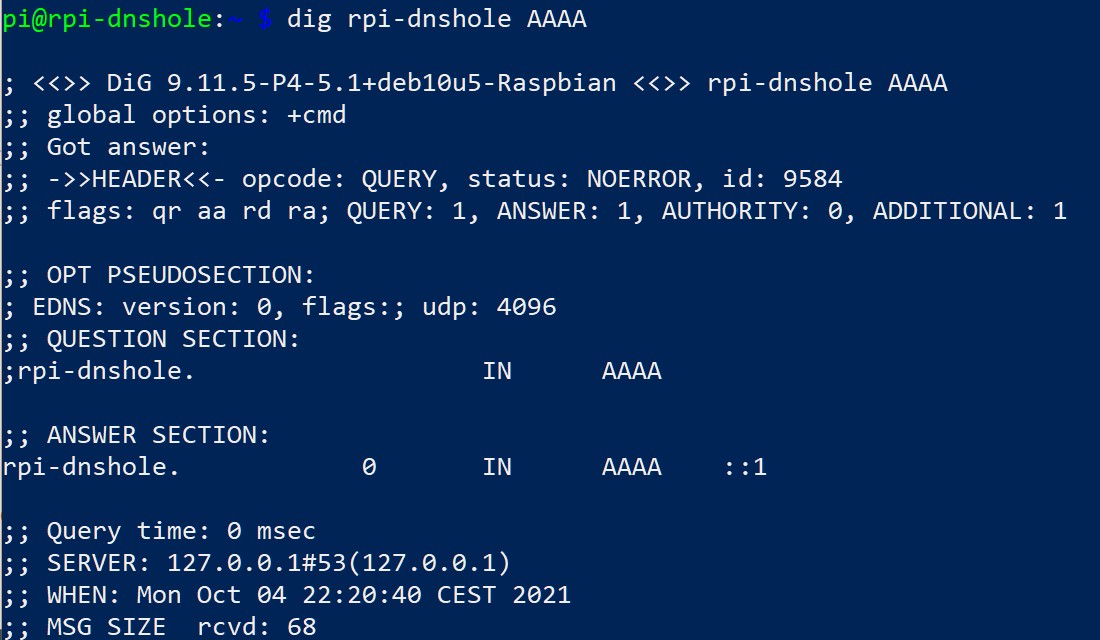

Made a dig rpi-dnshole on the server itself. think that made no sense and just confirms unbound is working properly.

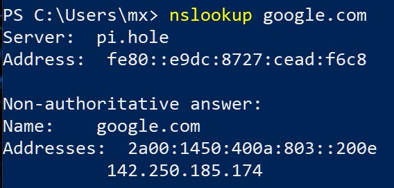

nslookup with rpi-dnshole as server to use. This uses the fe80: static local server IP provided with DHCP.

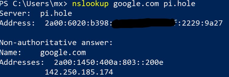

nslookup with pi.hole as server to use. This uses the IPv6 from setupVars section as shown in pihole -d

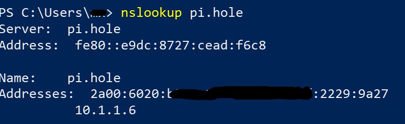

Noticed another thing:
when I nslookup pi.hole it shows both IP4 and 6. Only rpi-dnshole has lost his IP6 in query results

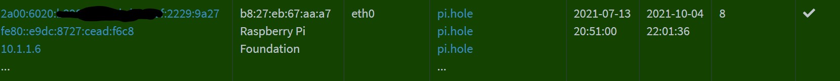

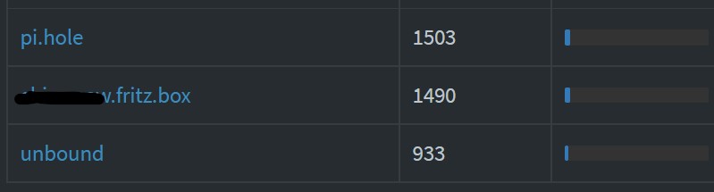

Since the latest updates the hostname also changed in dashboard top lists. What now lists as pi.hole was all the time before rpi-dnshole
There is really something fishy going on with my Pi-Hole.
Maybe it makes sense to run pihole -r again?
  • pihole -up Update also threw an error while auto updating installed packages because apt update detected kernel update. No other errors or warnings through the update process. Can this be related?

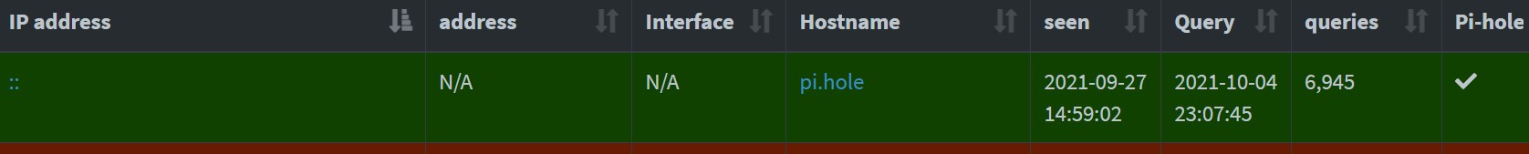

Then pi.hole exists twice in network table now. The rpi-dnshole hostname is just gone from Pi-Hole logs completely. Still can use it as hotstname for ssh or http access.

Interestingly, when using pi.hole for the admin panel instead of rpi-dnshole, the below requests are no longer constantly created while admin panel is open in browser.
