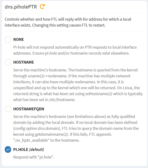

In the "TOP Clients" section of the Pihole admin dashboard some Requests have a Request number for ip address "pi-hole". Using nslookup I can see an address for pi-hole" has been created by pihole which jumps around from one pihole server ip address to the other. How do I stop this pihole behaviour by modifing pihole. I just want to see Request totals against the "real" ip addresses and no "pi-hole" address resolvable?

It will be one of these configuration options depending on what you'd like to have happen.
Hi nosugref42 The pihole servers do have full static addresses and do not use dhcp to request an address. Their ip addresses do not change. I don't care which pihole server responds to a client dns query. I just want the dashboard to total request numbers using their real addresses so I can determine accurate request numbers for each. Just seen DanSchaper has the answer to solve my problem.
Wonderful - thanks Dan. Made the change on each, restarted pihole and it is fixed. Appreciated.
