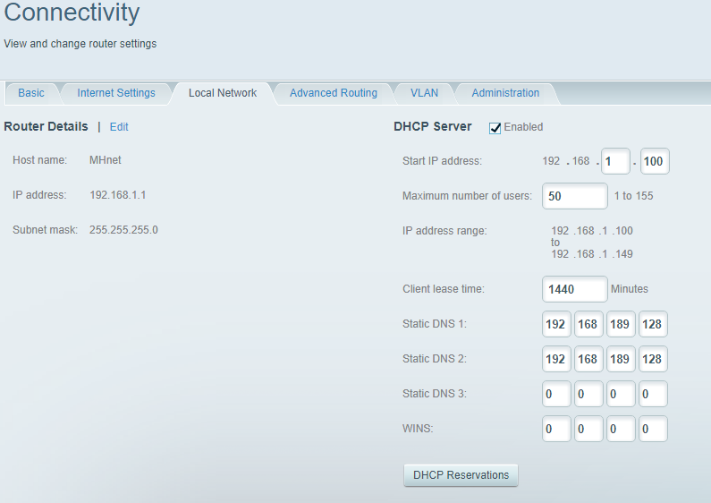

I have Pi-Hole installed on Ubuntu running on a virtual machine via VMWare with Windows 10 host. I believe I have everything installed correctly, and I'm able to access the web admin panel for Pi-Hole with no problem. Below is the configuration of my router. The IP address for Pi-Hole is 192.168.189.128.
I should also note that I also use a VPN for this machine (it's a media server). I have tested everything with the VPN disabled and enabled and I see no difference.
I've searched for hours trying to find a solution but I cannot find anything that works, so I hope someone here may have some insight! Please let me know if I can provide any more information that may be helpful.

Can your device access the Pi-hole's web interface via pi.hole or IP?
Edit: It looks like you have Pi-hole on a different subnet than your clients.
Thank you for noticing this, Mcat12!
I forgot to bridge the network connection between the virtual machine that's running Pi-Hole and the host. Now I have everything on the same subnet and it's working great.
