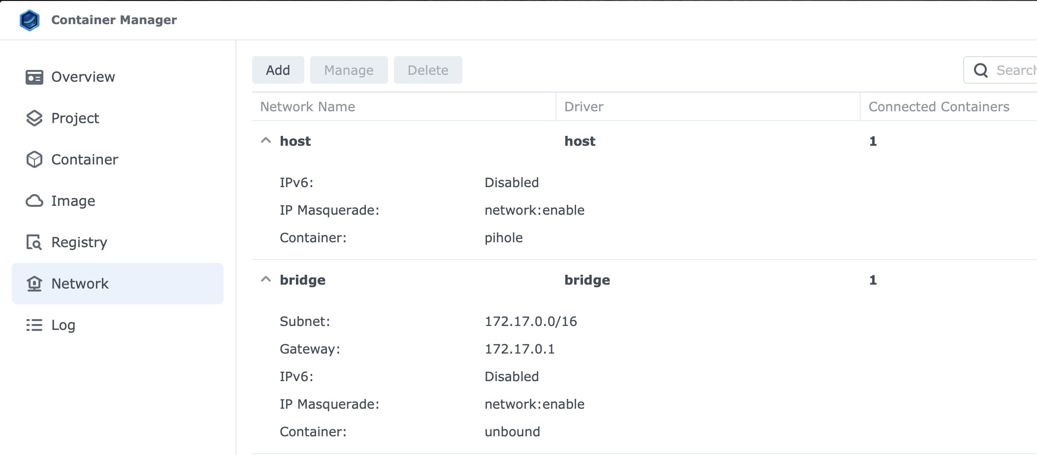

Are Pi-hole and unbound running in the same docker container? If not, you cannot use the loopback IP in the Pi-hole container and reach unbound in a separate container.

In addition to jfb question, can you also post details about your docker container (or containers if you are running Pi-hole and Unbound in separate containers):
  • which image(s) and tag did you use?
  • are you using Environment Variables for Pi-hole? Which ones?
  • which network mode the container(s) is(are) using? host? bridge? macvlan?

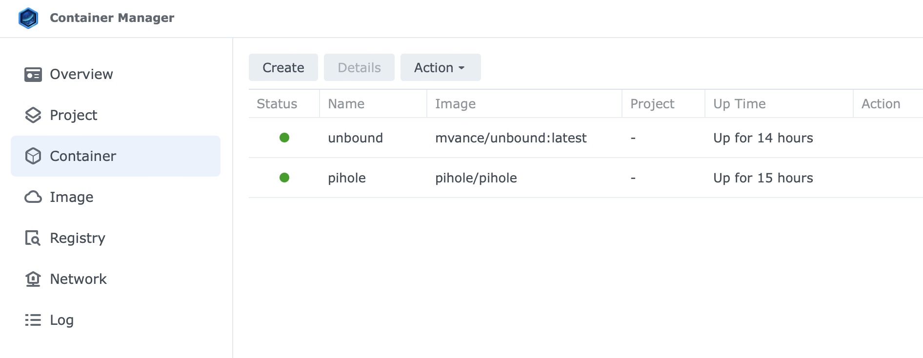

I have 2 containers (I think, sorry am new to this)

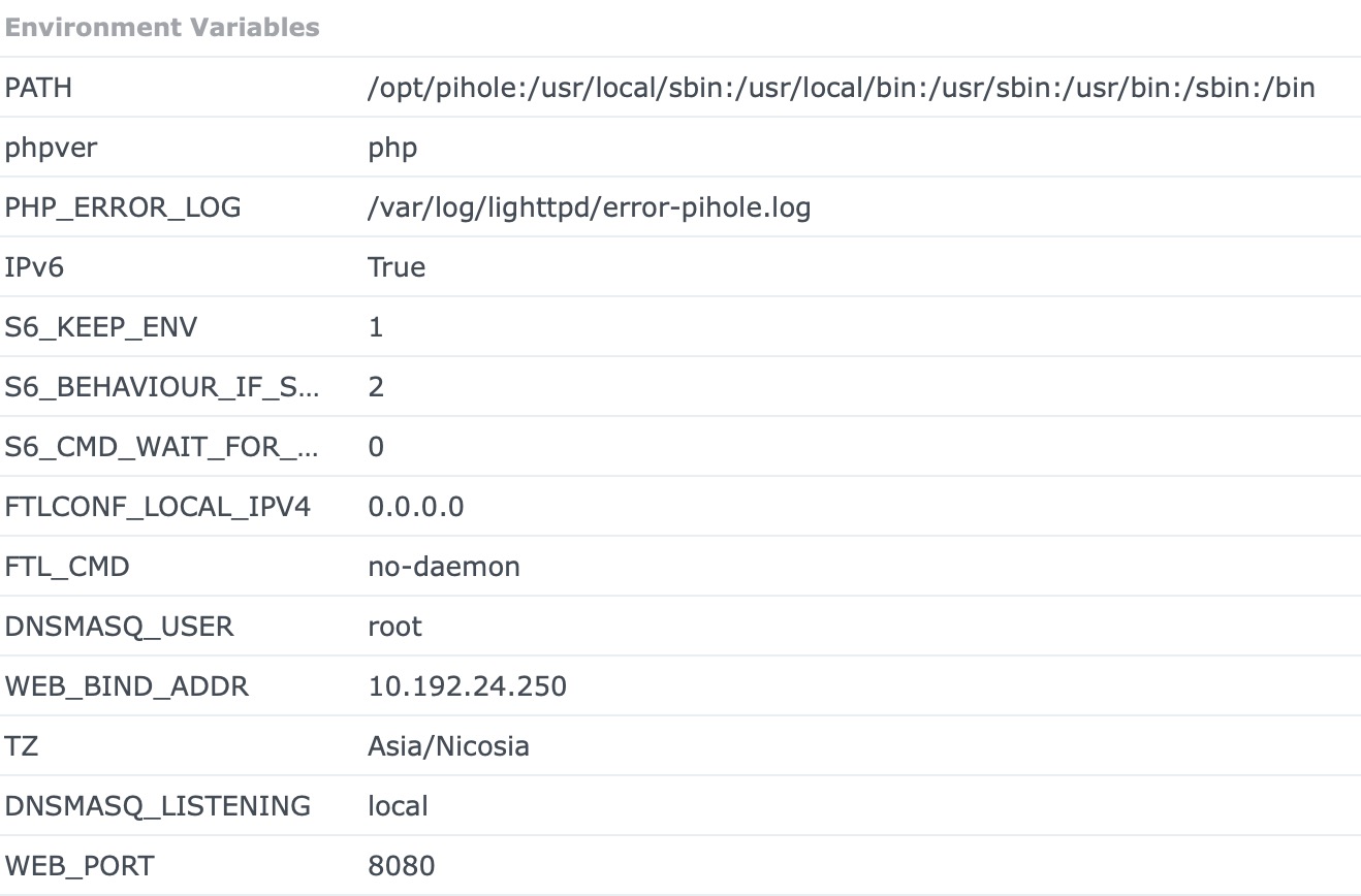

    docker run -d --name=pihole
    -e WEB_PORT=8080
    -e WEBPASSWORD=@@@@@
    -e WEB_BIND_ADDR=10.192.24.250
    -e TZ=Asia/Nicosia
    -e DNSMASQ_USER=root
    -e DNSMASQ_LISTENING=local
    -v /volume1/docker/pihole/dnsmasq.d:/etc/dnsmasq.d
    -v /volume1/docker/pihole/pihole:/etc/pihole
    --net=host
    --restart always
    pihole/pihole

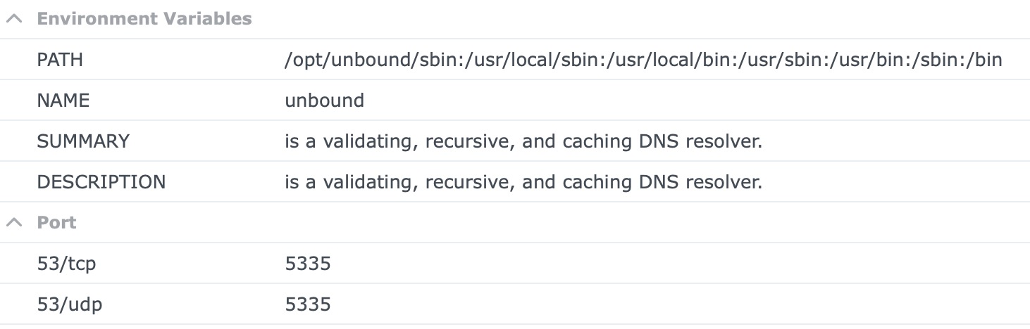

For Unbound, I used: sudo docker run --name unbound -d -p 5335:53/udp -p 5335:53/tcp
--restart=always mvance/unbound:latest
Pihole environment variables:
Unbound environment variables:
  • which network mode the container(s) is(are) using? host? bridge? macvlan? - See screenshot

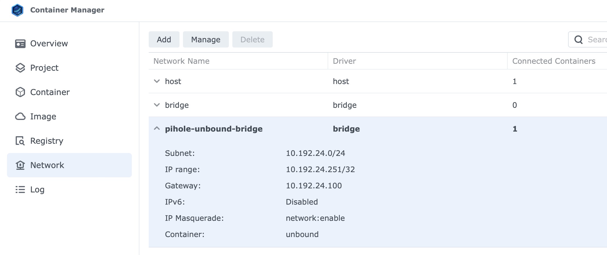

Update:
Looking closer at the original network setup in container manager, I decided to create a new bridge with a manual IP configuration for my subnet. I added Unbound to it and removed from the original bridge network. (screenshot below)
From the Pi-hole GUI DNS section, I removed the 2 Cloudflare DNS servers and added my own custom1 - 10.192.24.250#5335 which is the Synology IP and saved.
Going back to the pihole.log, there are no more SERVERFAIL errors and seems to be working as expected. (Pihole.log below)
I configured my client to use 10.192.24.250 for both DNS server settings, however this causes browsing issues and no page can load.
When I change the DNS servers on my client to use my IP 10.192.24.250 as primary and Cloudflare's 1.0.0.1 as secondary, everything works again, presumably as Cloudflare is doing the resolving.
Any thoughts from here?
