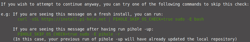

My machine is linux (mint) but how to skip the check? I can't even with this guide Prerequisites - Pi-hole documentation
help.
What command did you use to install without checking for a supported OS?
Please share the exact command.
### curl -sSL https://install.pi-hole.net | bash
That is the standard install procedure.
Did you try to run one of the commands as recommended by both our documentation and the installer itself yet?
Re:
  [✓] Checking apt-get for upgraded packages... 1 updates available
  [i] It is recommended to update your OS after installing the Pi-hole!
  [i] Checking for / installing Required dependencies for OS Check...
  [✓] Checking for grep
  [✓] Checking for dnsutils
  [✗] Unsupported OS detected: Linuxmint 20.3
      If you are seeing this message and you do have a supported OS, please contact support.
Which command did you run to produce your above output?
Read again :smiley:
Ok... :cry: Sorry.
I don't know if you quite understood @deHakkelaar . The command you need to run is right there in the picture :slight_smile:
If you haven't tried it yet, this is the command that you should run:
curl -sSL https://install.pi-hole.net | PIHOLE_SKIP_OS_CHECK=true sudo -E bash
