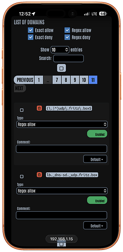

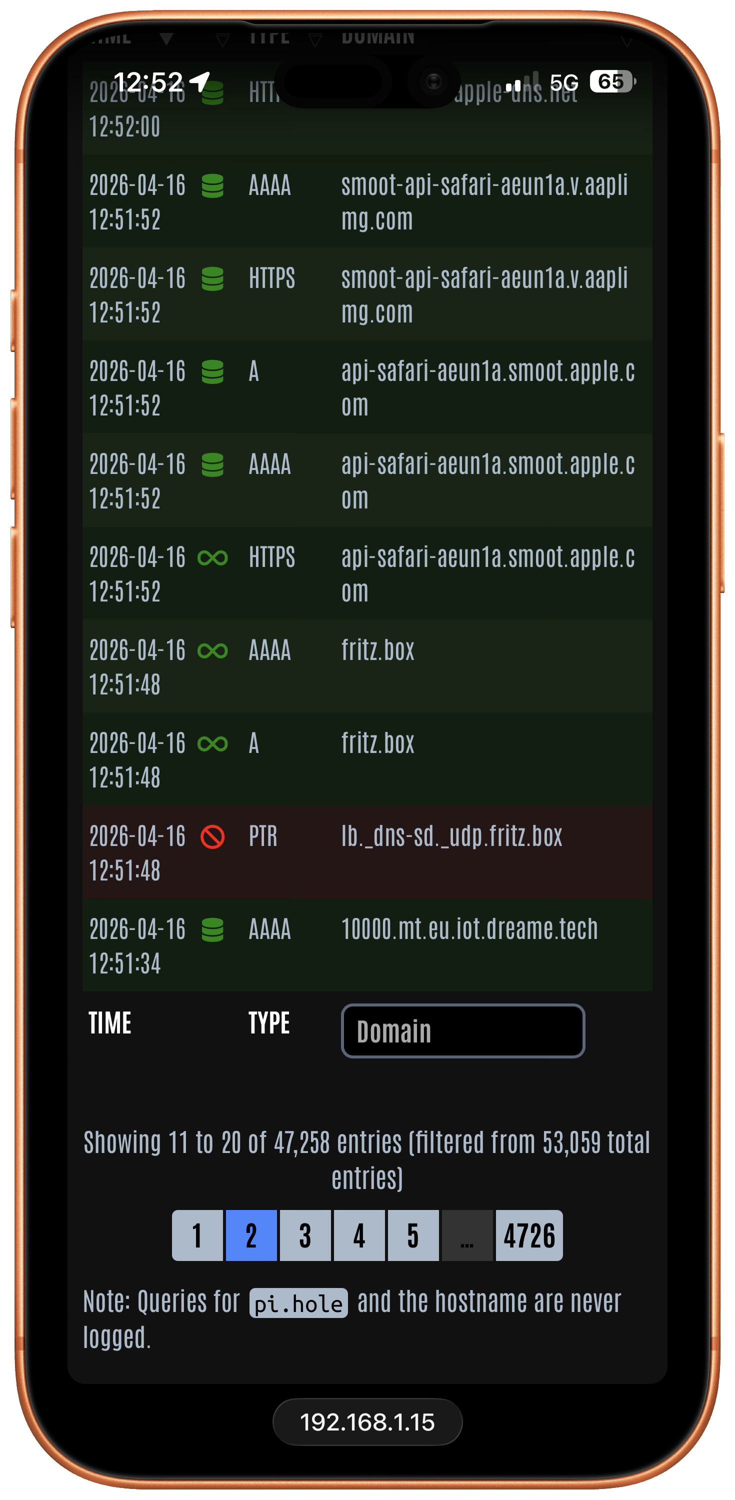

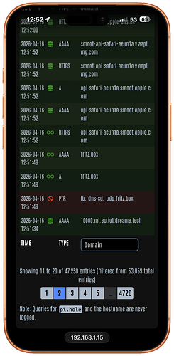

I Use the latest Pi Home on a Raspberry Pi 4 nimmst Network. In the query log I often see
Ib._dns-sd._udp.fritz.box

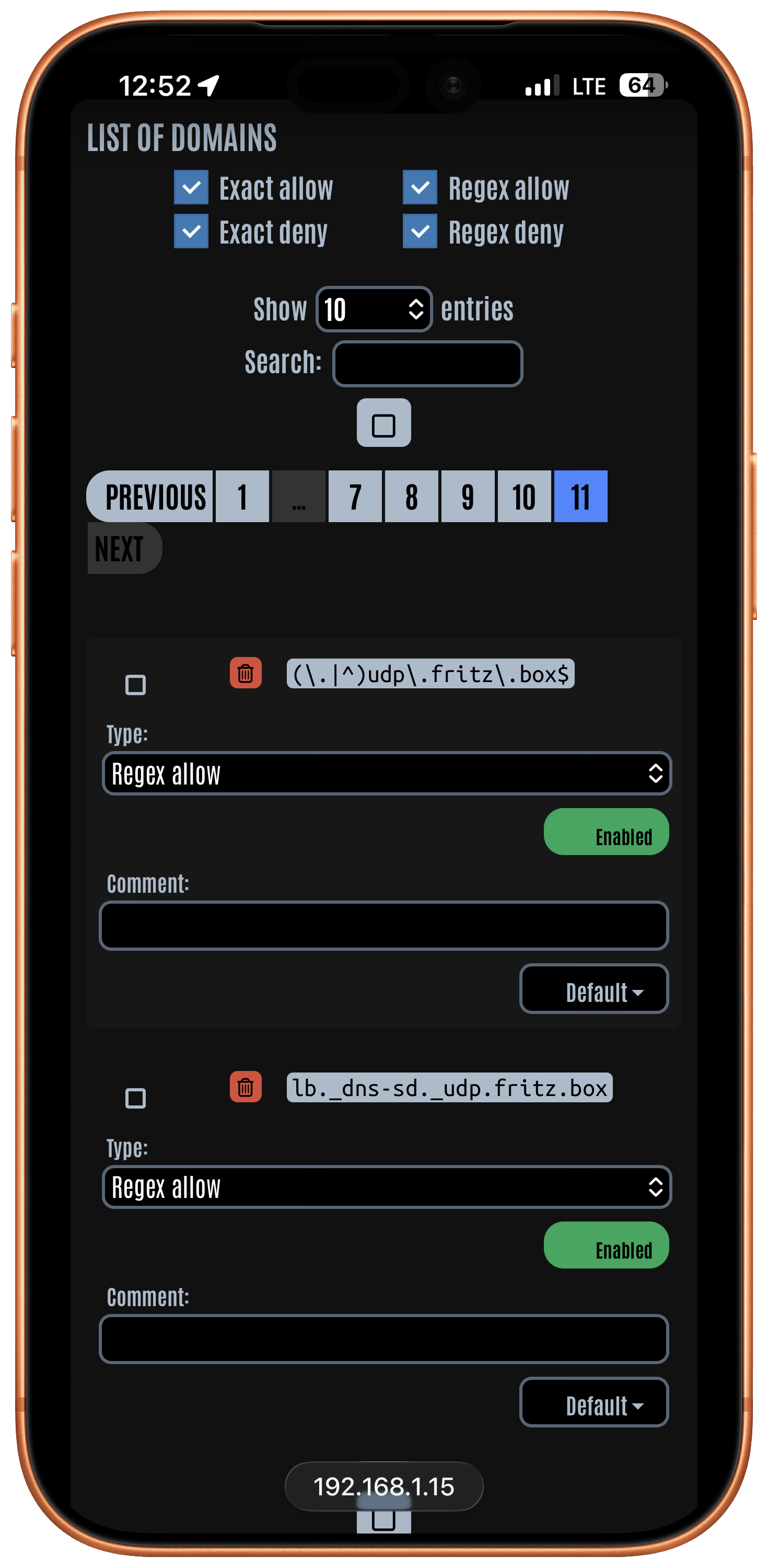

I put this to my allow list but I didn’t work see this message every day
See screenshots
Despite the fact that the address is allowed, it is blocked

Some of your regex expressions won't match on lb._dns-sd._udp.fritz.box, e.g.:
$ pihole-FTL regex-test "lb._dns-sd._udp.fritz.box" "(\.|^)udp\.fritz\.box$"
[i] Compiling regex filter...
    Compiled regex filter in 0.787 msec
Checking domain "lb._dns-sd._udp.fritz.box"...
    NO MATCH!
   Time: 0.273 msec
But as others would match, that would suggest that queries may not have been blocked by Pi-hole, but by its upstream - in case of lb._dns-sd._udp.fritz.box, that would have been your Fritzbox router, as that is handling *.fritz.box.
Let's take a closer look at some of those PTR requests during the last 10 days. Run from your Pi-hole machine, please share the output of:
sudo pihole-FTL sqlite3 --header --column /etc/pihole/pihole-FTL.db \
"SELECT reply_type, status, forward FROM queries \
WHERE type = 6 AND domain = 'lb._dns-sd._udp.fritz.box' \
AND timestamp > strftime('%s','now','-10 days') LIMIT 10;"
reply_type  status  forward
1           8
1           8
1           8
1           8
1           8
1           8
1           8
2           8       192.168.1.1#53
2           8       192.168.1.1#53
1           8
A status of 8 confirms that lb._dns-sd._udp.fritz.box is blocked by Pi-hole's upstream (see Supported status types from Query Database - Pi-hole documentation):
ID Status Details
8 Blocked :cross_mark: By upstream server (NXDOMAIN with RA bit unset)
Pi-hole's web UI should also list respective query log entries as (Blocked, external) when hovering over the blocked icon or inspecting an entry's details.
