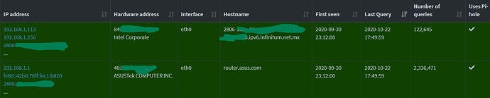

Hi, it seems my ISP has finally assigned me an IPv6 connection, and most of my devices have acquired IPv6 addresses within the last few weeks. I am able to see both their IPv4 & IPv6 IPs on the network management section (I use my Pi-Hole as the network's DHCP server), but for some reason, none of the connected devices are able to solve websites using IPv6.
