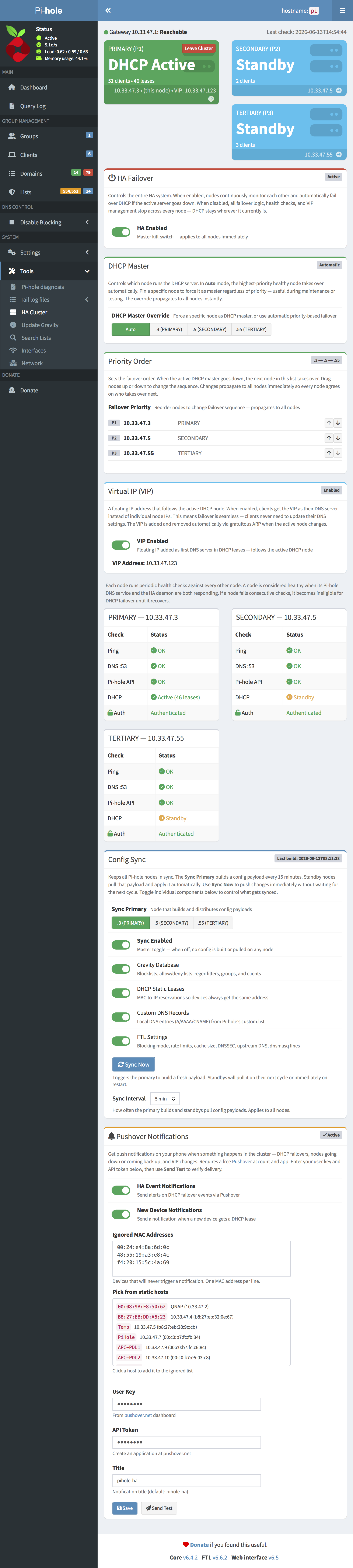

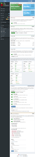

i tackled the HA thing on my side and ended up with it like this …
